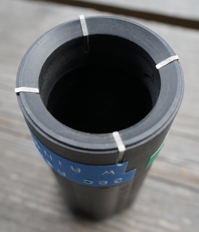

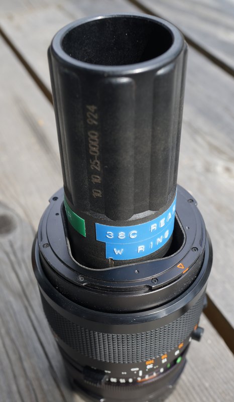

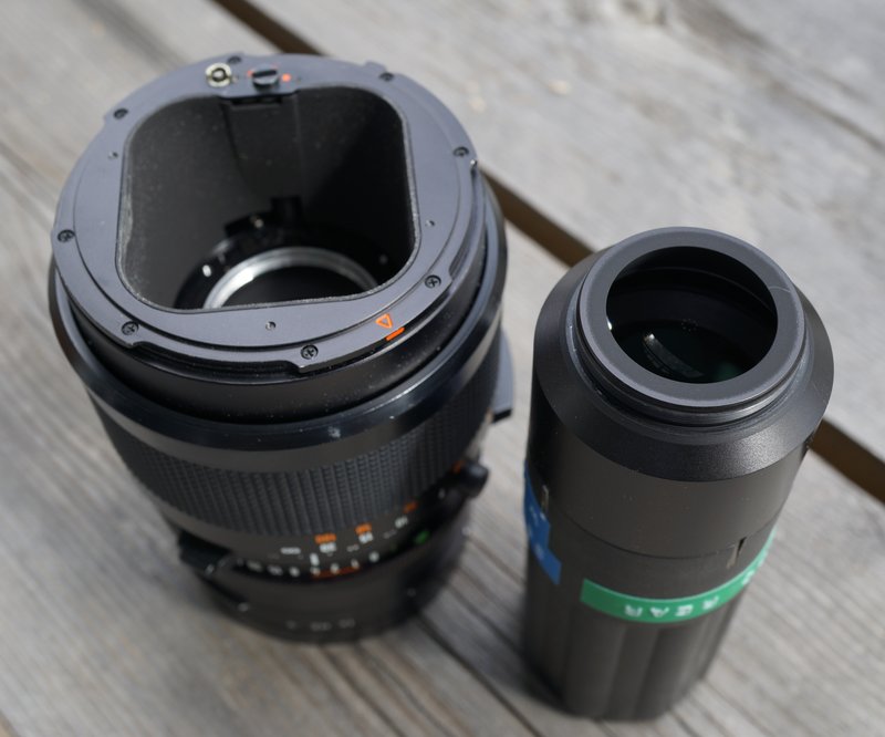

Hasselblad rear group lens tool 10-10-20-000-924 (Not mine, just borrowed)
3 of the 4 notches on a 150CF that the tool mates to...
Lens tool 10-10-25-000-924 inserted into the rear group
Rear group removed for cleaning.
It's not unlike the copal shutter tools for LF lens boards, only easier.

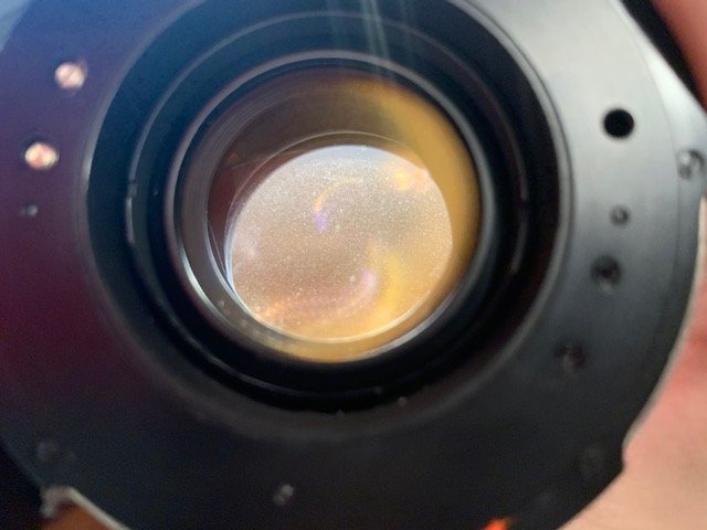

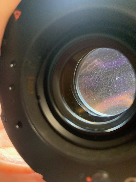

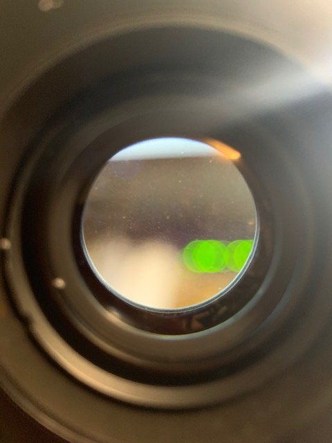

I just bought a 500c that come with 80mm C lens. The camera is in very good condition, but I found dust/haze in the internal lens, possibly next to aperture / shutter as mention in this thread.
Not sure if the haze we discussed here look like this? The first picture shows almost clear lens when looked straight. I am trying to decide whether I should return it:
Grim Tuesday
Oct 1, 2018
739
Philadelphia
Looks like it could be either fungus or haze to me. Fungus because of how thick it is, but I'd lean towards haze because it doesn't have the usual branched fungus structure.

I would return it. It is your hard earned money and you should not accept something that is not right.
