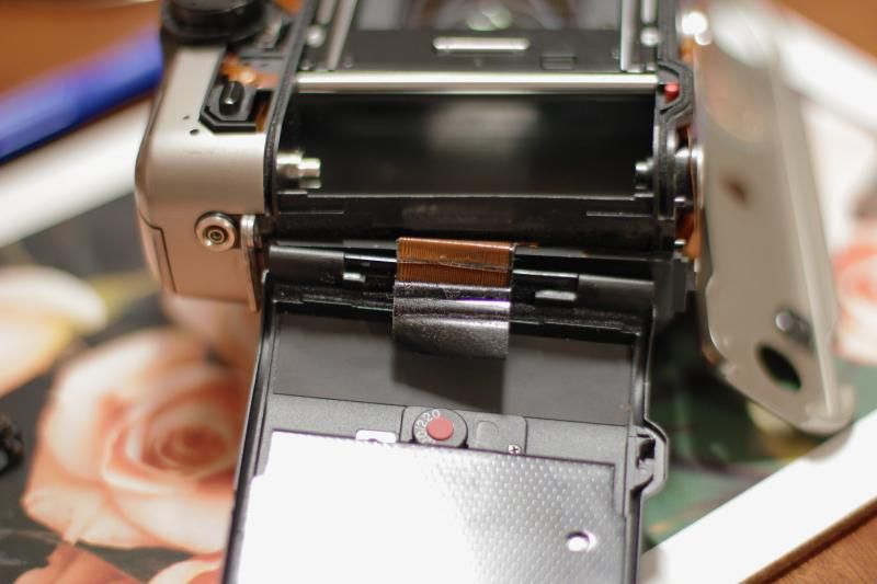

Little update,
I disassembled the camera enough to be able to inspect the ribbon cable.
Unfortunately the way fuji had decided to route this ribbon forces a couple sharp bends on a not so flexible cable. Causing a lot of stress on this very important cable, especially when the film door completely open.
I would recommend anyone with a working GA645Zi to try and avoid allowing the door to open all the way. Maybe try to load film resting the camera between your legs allowing the door to only open 90 degrees (or something like this). This will surely postpone cracking the ribbon and extending the life of your camera.
Below is a photo of the damage done to my ribbon, it is completely split in two.
I will be doing some research for techniques in repairing/ joining this sort of ribbon but i don't believe it is going to work as extra length on this ribbon is key.
To make the camera usable I am planning on identifying which contacts on the ribbon are connected to the door switch, and do what i can to connect the door switch back into the computer. So at least the camera will not think that the door is always open and can auto advance the film through the camera.
I have two weeks left in the country, I doubt I will be taking this camera on holidays with me.... :sad:

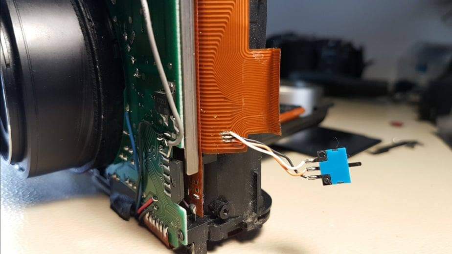

FOTOTECH Poland
Nov 7, 2020
Warsaw
Check first photo, it shows which paths are responsible for rear cover microswitch.
We can replace flex for new one.

For those with the infamous GA645Zi cable break/LCD loss issue: Go on YouTube and do a search for this topic. There is a recent video posted by a repair company in Finland which offers to do the repair by replacing the cable with a new one. They remove all of the components on the old cable to the replacement cable. The video covers the entire process from initial disassembly of the camera to extract the defective cable though repair process and camera re assembly, in about 90 minutes. They offer to sell the replacement parts for DIY for $100 or will do the full repair for $270. (That may have been euros rather than dollars.) After watching the procedure and checking their website, I'd gladly pay to have them do the whole job. No idea where they come up with the replacement cable; I assume they make it themselves since they do not seem to have a shortage.
FOTOTECH Poland
Nov 7, 2020
Warsaw
Thanks for recommendation, but we are from Poland, not Finland ;-)
Youtube video you saw is ours. We do not have shortage of flex cable because we remanufactured them.

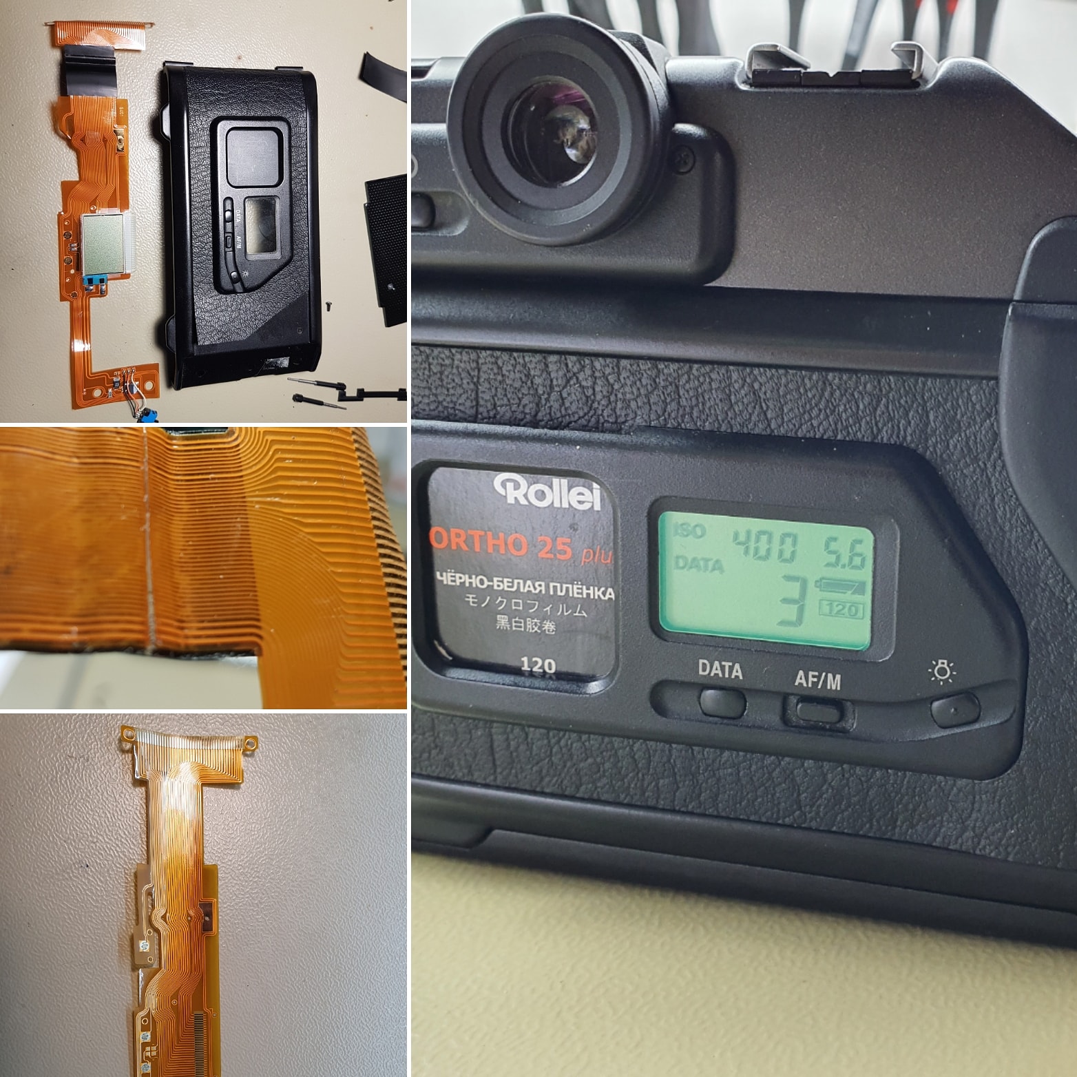

A lot or Zi from US repaired during last months. You can check us on FB or IG fototech_serwis

Just received my GA645Zi back from FOTOTECH. I purchased the camera here knowing the LCD was fading. Sent it off to Poland and about a month later the camera is back!
