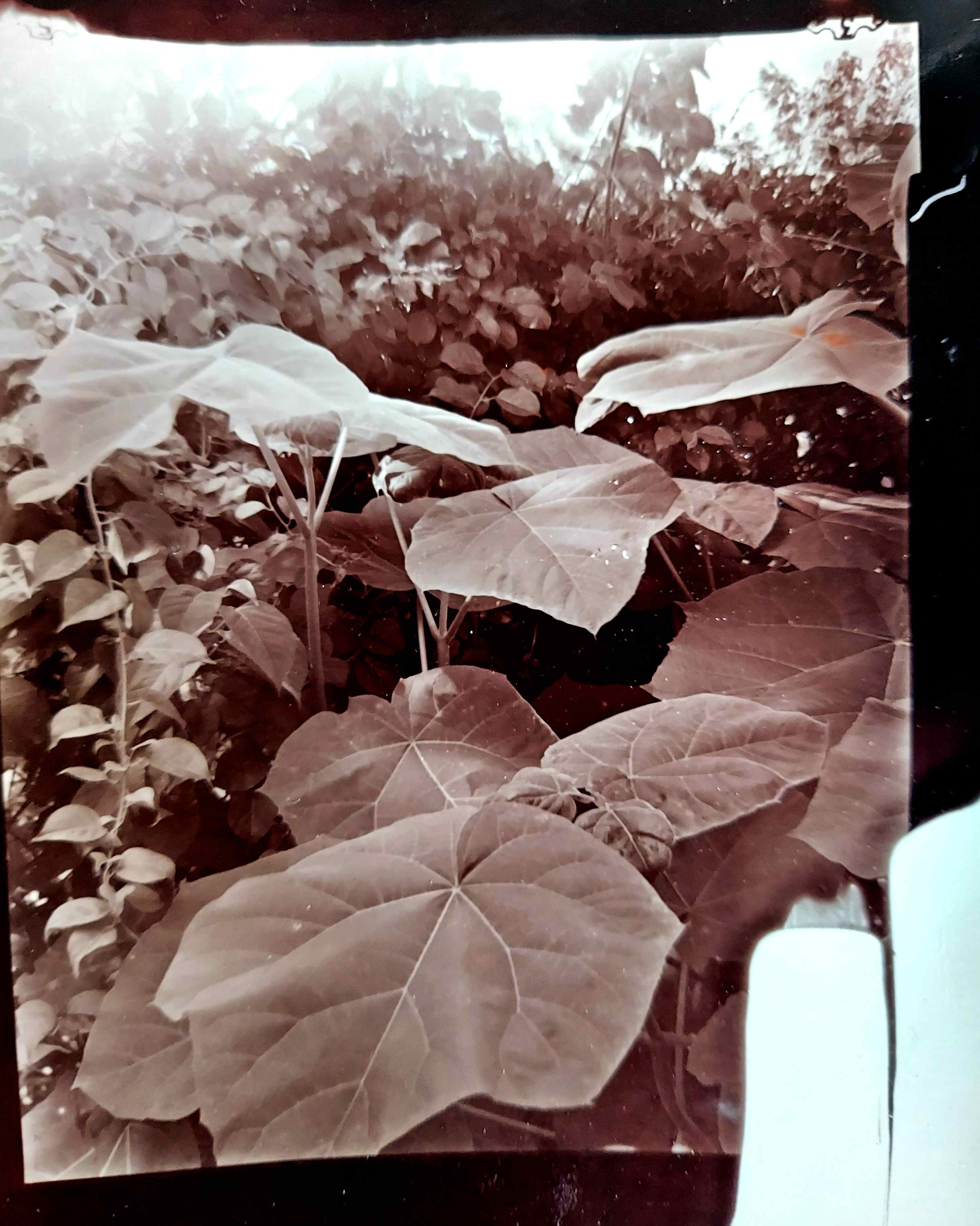

Here are 2 4x5 prints made on fixed out baryta paper. Toned gold
You can still go to the Chicago Alubumen works website and down load the instructions for toning the paper..its very straightforward
Mostly have fun!!
