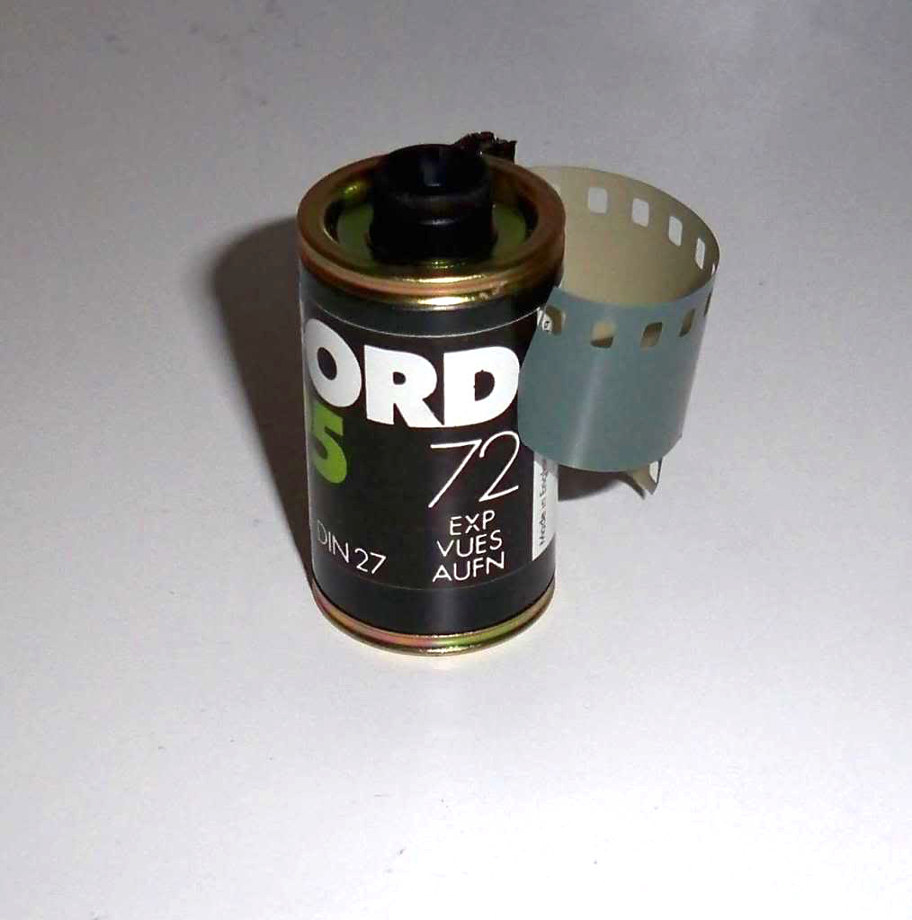

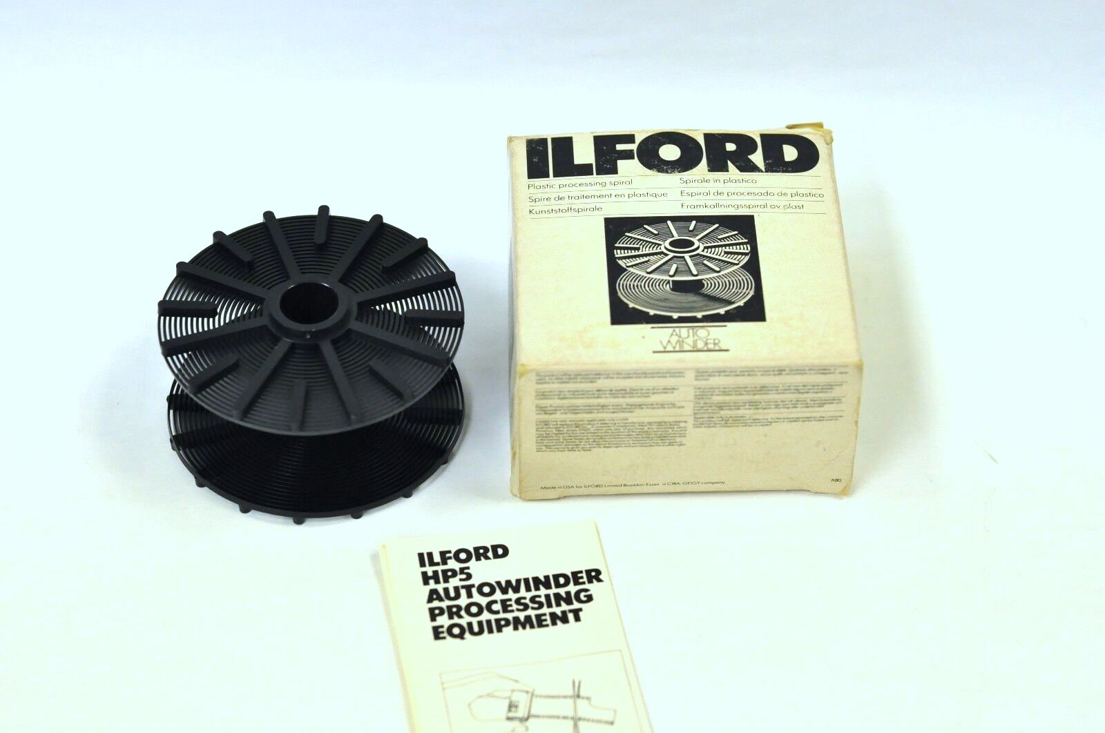

I used these reels in the 1980s for the thin film base, 72 exposure HP5 loads. Still have a few rolls in the freezer. I my cameras with this film, the counter keeps going up to 72. There was a special pressure plate, also, that had a thinner channel.
