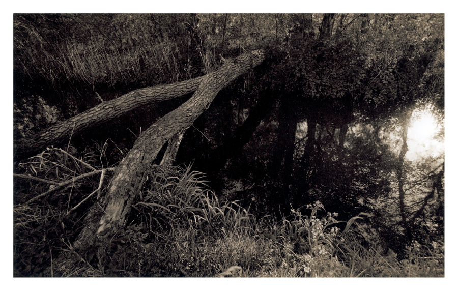

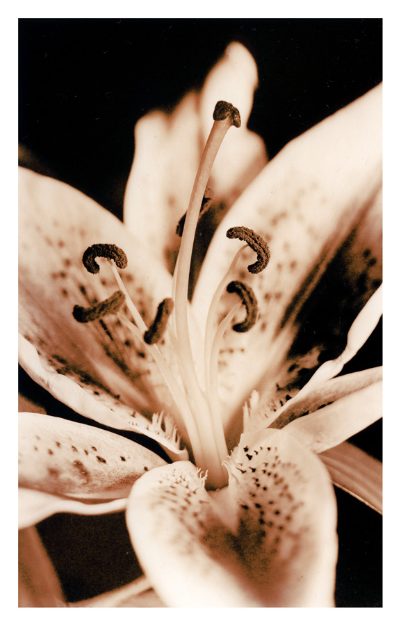

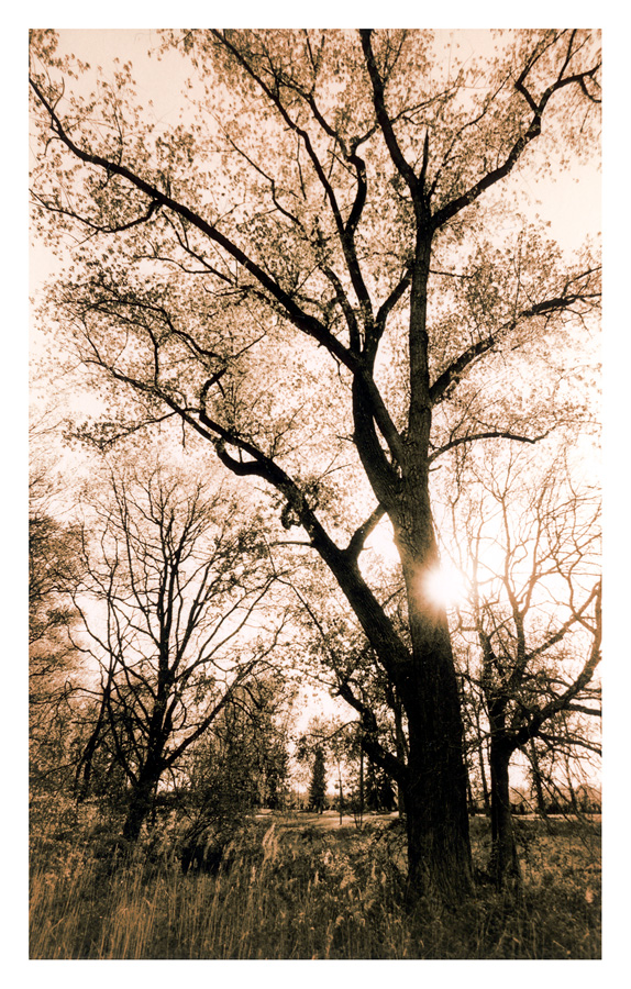

These are some of my attempts so far:
Untoned; Fomatone MG:
Selenium-toned, Fomatone MG:
Selenium-toned, Adox Variotone:
Fomatone seems to like a very dilute second 'polychrome' developer; much more so than any other paper I've tried so far. I ended up using the metol formula published by Moersch without the bromide and chloride mixed into the stock, diluted at about 1+100 (the pdf says up to 1+10, but this is far too strong for Fomatone even if the prescribed bromide is included) and with extra ammonium and/or sodium chloride added.
