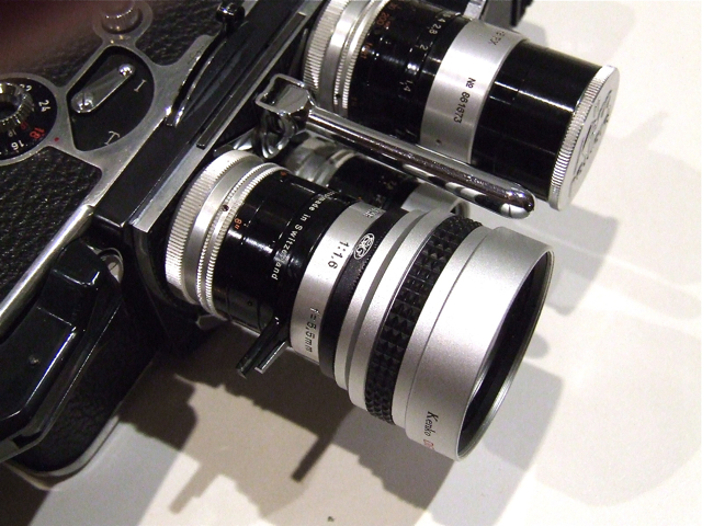

I had SK Grimes manufacture an adapter from Series-size thread to 37mm thread so that I can put a 0.5X wide angle adapter on my 5.5mm Bolex H8 Rex lens.
As you may know in the Bolex 16mm line they made a wide angle adapter for the 10mm lens, but as far as I can tell they never made a wide angle adapter for the 5.5mm lens for the H8 cameras.
Bolex Aspheron converter for comparison (10mm to 5.5mm for 16mm cameras):
This works great. It provides full frame coverage.

Pictures of the adapter and the 0.5 Converter:

This is the missing picture of the 5.5mm lens, SKGrimes adapter and 0.5x converter.

Copied your photo up thread.
