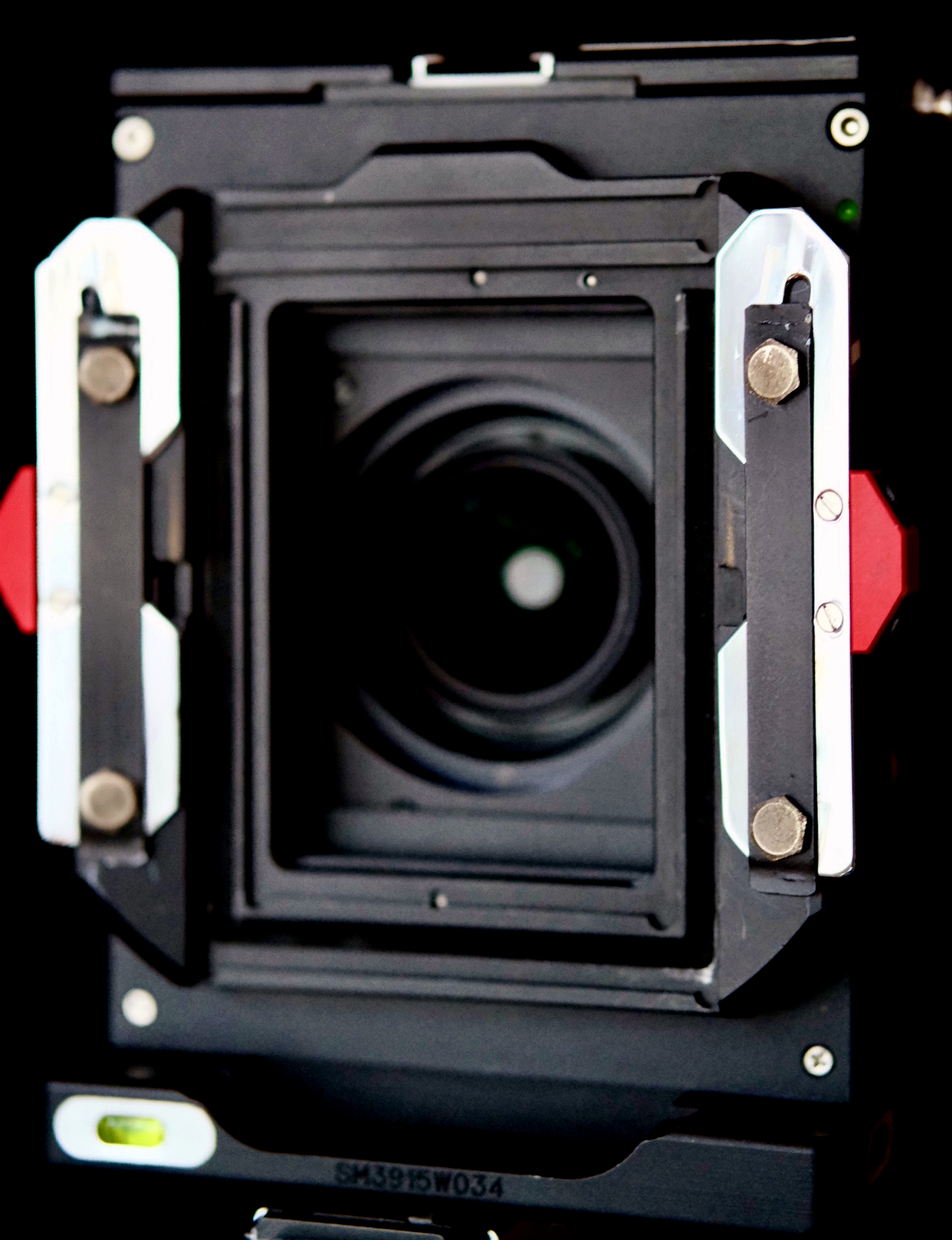

Linhof had these, but they don't fit the International 23 Graflex system.
I am still looking for these too.
See picture as an example.

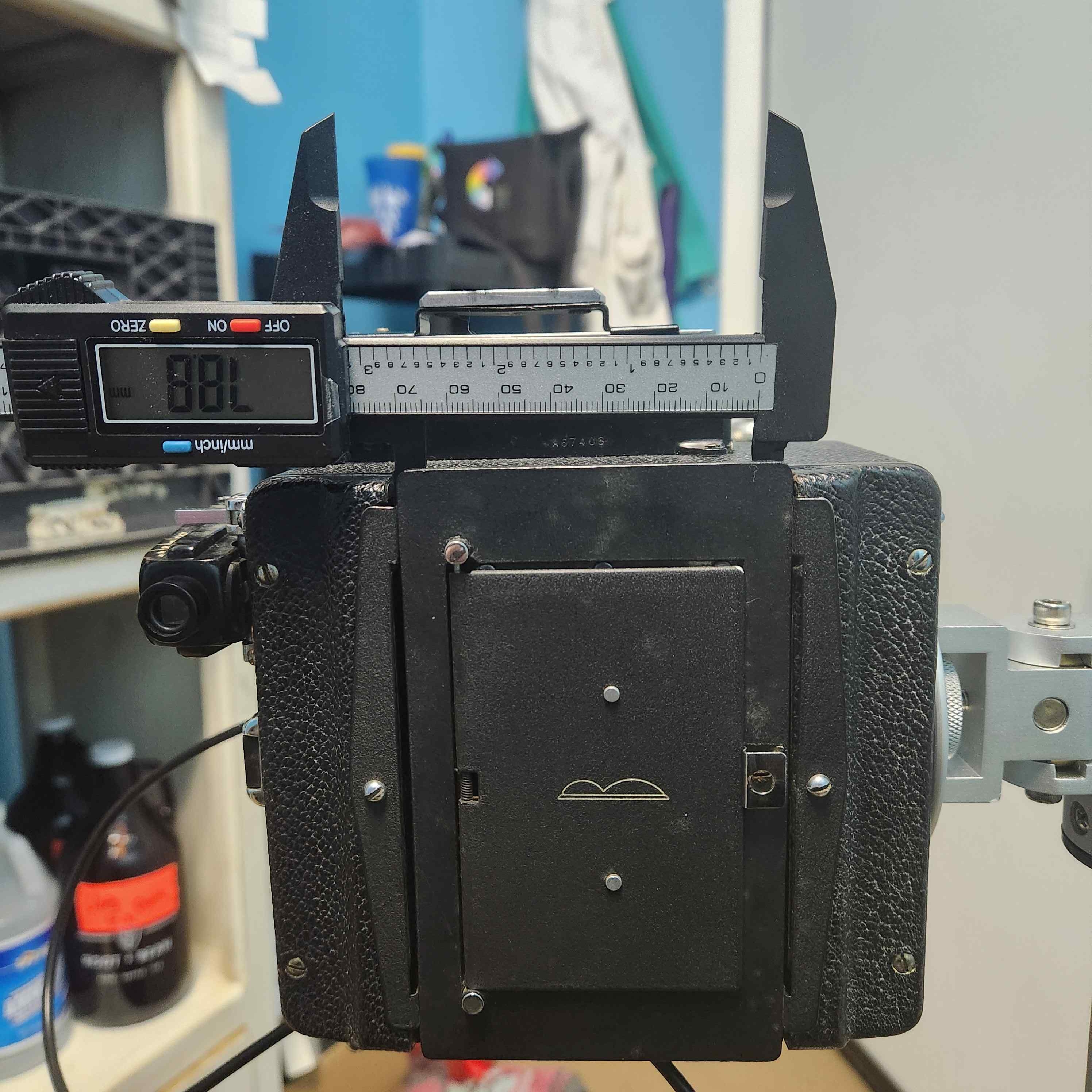

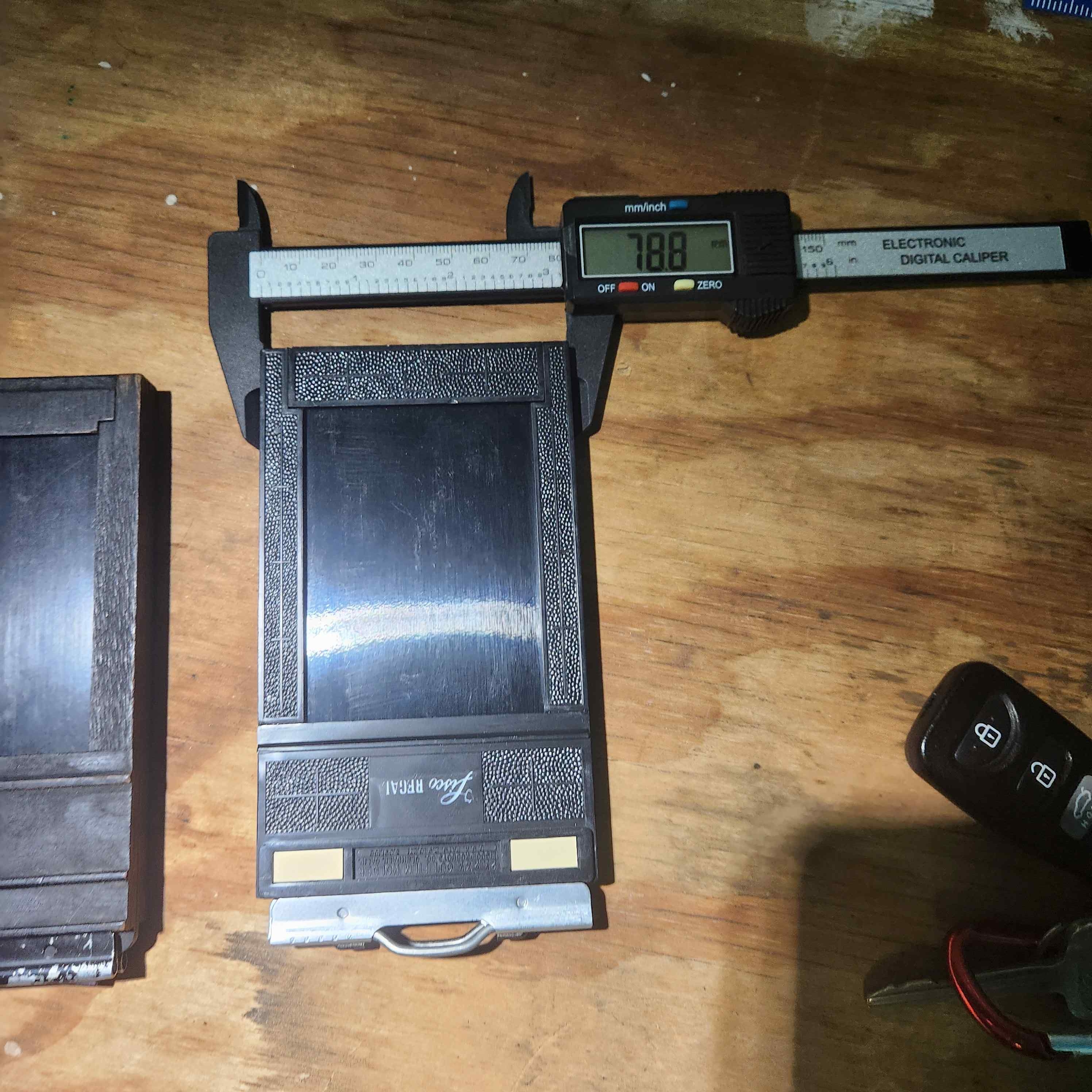

What is the spacing between the rails?
Caliper says 78.1mm for wooden holder that fits, 78.8m for lisco regal plastic holder that doesnt fit.
The opening for holder on the back is basically also 78.8mm.
The opening for holder on the back is basically also 78.8mm. View attachment 358426 View attachment 358427

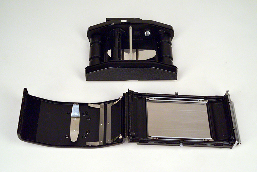

It is not the wideness alone that counts for the so called International Graflex 23 coupling system, nor the total thickness of the cassette.
The shape of the longitudinal side is at least as important. There should be a slot, a long grove actually, in it, and a screw in the middle.
In that slot the sliding thongs, the chrome tongs with the red handels shown in my previously shown photo, mus fit.
The linhof ones do not attach the same way, as these are made to be slid beween the spring held ground glass frame and the camera's backside, just like a traditional 4"x5" sheet film holder.

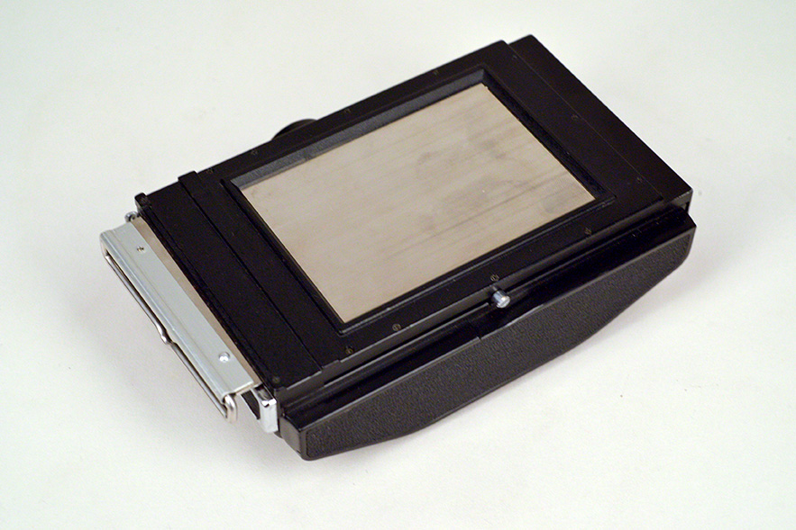

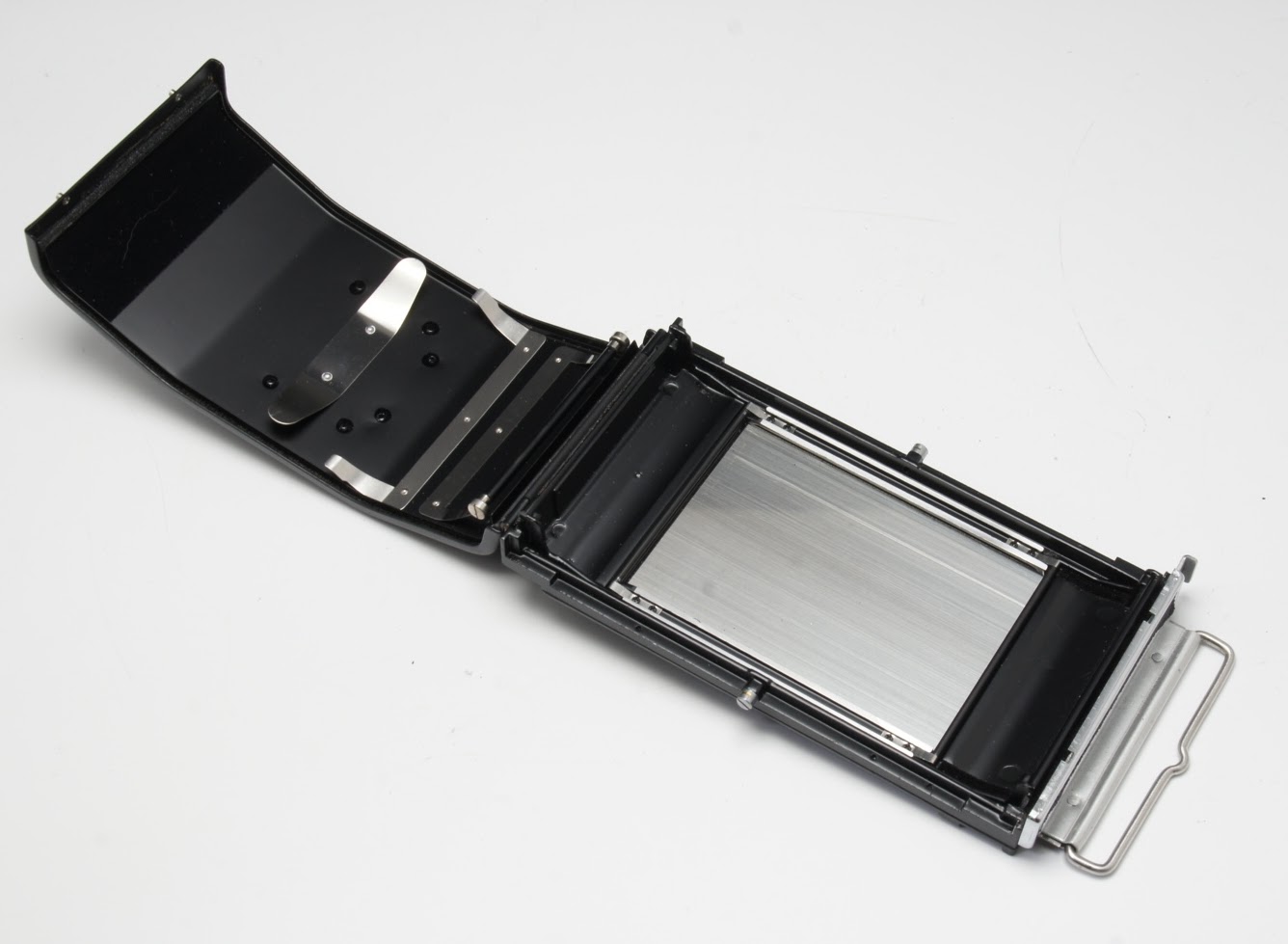

In the photos I attach now, you can see the shape of the camera side of a roll film cassette {a WISTA 6x9, which has the same pattern as the Horseman, the Graflex 23 and the Linhof Rollex (as used on the ALPA camera's)}.
In the first photo, if you look closely, you can see that grove with the chrome screw halfway of it, which is meant to position the cassette in the camera's 6x9 frame.
In the second photo you can see the inner side of the grove with the screws.
In the third photo you can see the traces made by the thongs when slid in that grove (a Wista cassette).
The thickness of the outer, camera oriented, side and the border of the grove is around 4 mm, the deepness of that grove is about the same.
The roll film- and the sheet film cassette must always be positioned with the dark slide upside, or on the right side when used horizontally.
For what it is worth, the American National Standard for the width of a 3x4 film holder is 78.17 to 78.97 mm. The Lisco holder is slightly within those limits. The Busch camera is not. This is assuming the calipers to be accurate. After a career in electronics, I trust the direct readout of traditional vernier calipers (despite human interpretation) more than the digital conversion of some easier-to-read digital calipers.
Thanks Jim. Interesting. That is very useful information to have about the tolerances of the standard.
Also explains why I have two film holders with matching manufacturer markings and patent numbers but one fits and one doesn't.
Jim, you are also confirming the conclusion that I coming to as well. The opening of the Busch camera itself is tighter than some of the 2 1/4 x 3 1/4 cameras that (I am assuming) came after it.
Next time I am in the darkroom I will sit down and sort them and measure and take some pictures to post here just as a summary in case someone else goes down this road.
And yes, that is a VERY cheap caliper.
I have since bought a couple cheap lots of 2 1/4 x 3 1/4 film holders. Have about 18 now
Some are graphic type, some are fidelity, some are Burke and James, some are unbranded.
Some fit, some fit extremely tight, some dont fit at all.
Some fit halfway and get stuck about halfway in. They taper up to the limit of the standard 78.8, 78.9 near the top where dark slide slots and dont insert fully.
I have one that is a little broken that I am going to use a test mule to try sanding down to get to fit the Busch.
It seems like I could take a half a mm off of each side with sanding without introducing light leaks.
