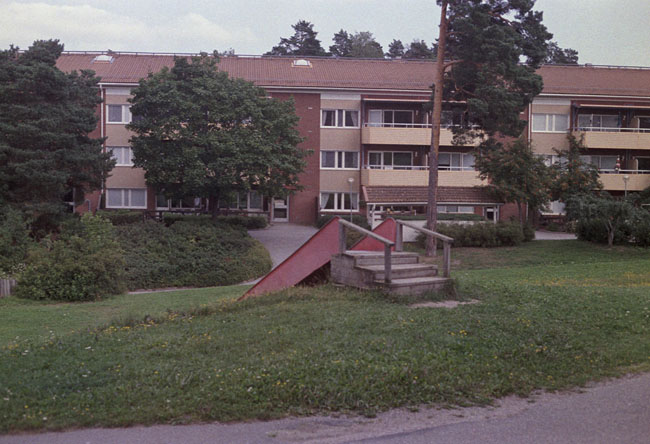

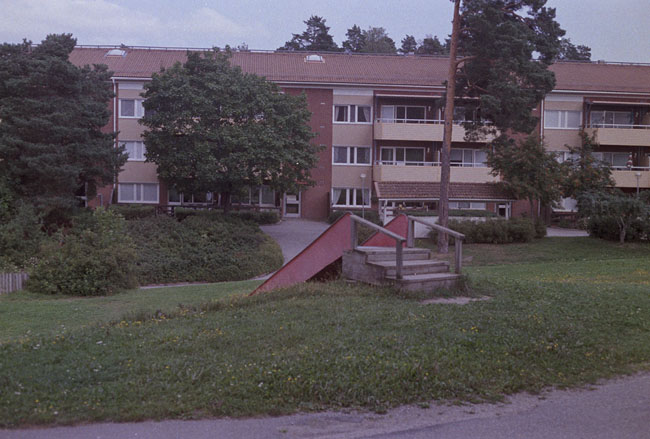

I received my Rollei Digibase C-41 kit a few days, and I shot a few test rolls of Fuji Superia 200 to try (and to practice) some different methods. I have not been processing before, so I lack a lot of knowledge.
I use a Paterson dev tank, and my first roll was developed at 37.8 deg C, using a water bath to keep the temperature. Next of was a roll at room temperature, which in this case was 25 deg C. I'm quite happy with the result, even though I think I should send a test roll to a pro lab to get a benchmark.
Then, I tried stand developing, mixing 5 ml devA, 5 ml devB, 5 ml devC, 0.5 ml starter with 275 ml water (the tank needs 290ml of working solution). Agitated the first minute and then let it stand for an hour, then following the ordinary process at 25 dec C. The result was interesting. My problem I have is that I don't know what's wrong with the photo. Is the film over- or underdeveloped?
The photos are direct from the scanner, without any post processing.

Hi -
On the roll that you stand developed, what temp was the developer at when you started? Either way, Rollei doesnt reccomend stand development times at all. I believe you overdeveloped it. They do provide a development at 25 degrees C for 13 minutes with 1 agitation every 30 seconds. They also provide a develop at 20 degrees C for 21 minutes with 1 agitation every 30 seconds
Here is their guide that I use from Freestyle:
http://www.freestylephoto.biz/pdf/product_pdfs/rollei/RolleiMaxiKit_C41_InstructionManual.pdf

I tried stand developing just for the fun of it. Following the instructions is clearly the best way to go, if one wants good results. Being new with film processing, I think I can learn a few thing by not following the instructions, since by making things wrong, I at least know what not to do. I will try do lower the concentration of the chemicals in the working solution, in order to decrease the development of the film.
The temperatures on the developer was 30 deg C.
Thanks zsas for the links, interesting reading I must say. I'll try your method ad 38 deg C with added washing.
