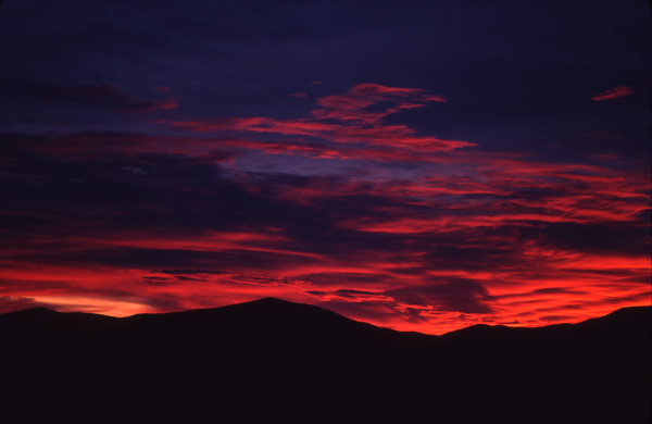

It's all in the metering.
This is a sunrise instead of sunset, but same difference more or less, on Kodachrome, in camera meter.
As I recall, I metered on the sky here, then reframed. If the sun will be in the frame then point the camera somewhere where it's not included, meter then go for it.

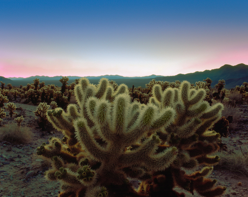

As already stated, slide film has an extremely narrow exposure latitude, however, if you control the light it can be very rewarding too.
I used this image in a post with regard to using Neutral Density Filters in general. It can also be used here with regard to sunrise / sunset photos and slide film as others have shown. This was taken using a Hi Tech Reverse Grad Filter. They're specifically designed for shooting these type of shots.
