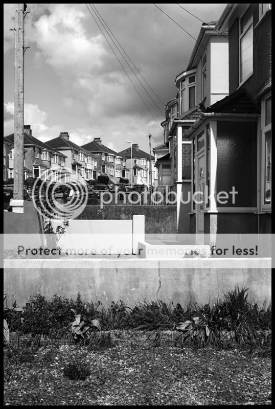

My first image from the Toyo C Monorail with the 90mm f8 Super Angulon (1/15 sec @ f22), not 4x5 though just a frame of 6x9. Pan F @ ISO32 developed in Caffenol CL, the shot was unintentionally pulled. I realised after I had processed the negatives that whilst I had a lovely negative with a full range of tones, I could barely see the frame numbers that Mr Ilford had so lovingly exposed for me on the film, this has always meant to me that the film was underdeveloped.
This got me to pondering (dangerous I know) what could have been the cause of the underdevelopment, I suspect that it was because I have started to up the Potassium Bromide slightly (from 0.5g to 0.7g in 500mls) to reduce the base fog, but I was surprised at how much of a difference it seemed to have made.

So after all that, here is the image that started it all: Oh, the crappy bit of foreground (chippings and unkempt plants) is part of my front garden.
If you want to see the full sized version click on the link below the image.
Toyo C Monorail 90 SA 6x9 large by Ed Bray, on Flickr
Congrats on the first image - looks like a very good tonal range there, however unintentional!
