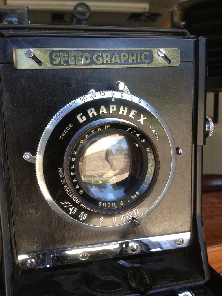

I dont have any ND filters, but I'm glad you brought that up. Would you happen to know what kind/size of filters I need for a Speed Graphic with this lens?
If I had to make a Scientific Wild Ass Guess I'd say 49mm, roughly 1.93" (just shy of 1-15/16").
Put a ruler to it, just remember that thread sizes are measured to the outside of the threads.
Also if you have a larger filters, say 52mm for your 35mm cameras. there are step up rings.
Yeah, but I dont think this lens has normal filter threads...
Why would you think that?
Huh... Look at that, it does have filter threads.
You need a series filter adapter. Somewhere I have a table of sizes. If I find it soon I'll post the exact size you need.
Chris, measure the outside of the front lens barrel with a ruler (to the nearest 1/16 inch or to the nearest mm). On ebay there are sellers of series adapters. Buy that size adapter. It will either be Series VI or VII... IDK for sure. It should be rather obvious, though, which is available. Make sure you get eitehr a retaining ring or a lens hood -- one or the other is necessary to hold the filters in place. Then look for filters in that size. If you have a choice, Series VI filters seem more easlily available than VII filters.
