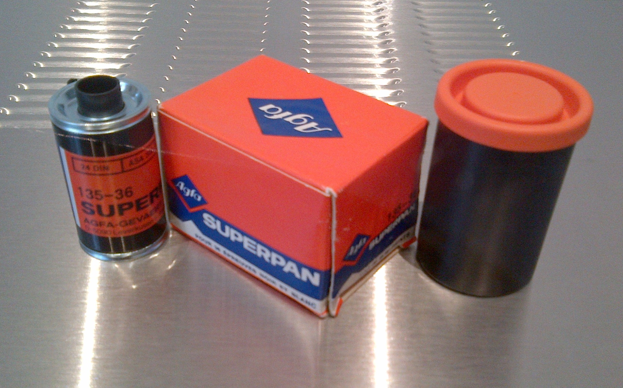

OK, here's some photos -- of the film itself, and pictures I've taken with the film. The picture of the violinists was taken with a Topcor LTM lens and developed in Ilford ID-11 1:1 while the bread picture was taken with an early 5cm Nippon Kogaku F-mount lens and developed in Obsidian Aqua. I rated the film at ASA 100, given its age.
