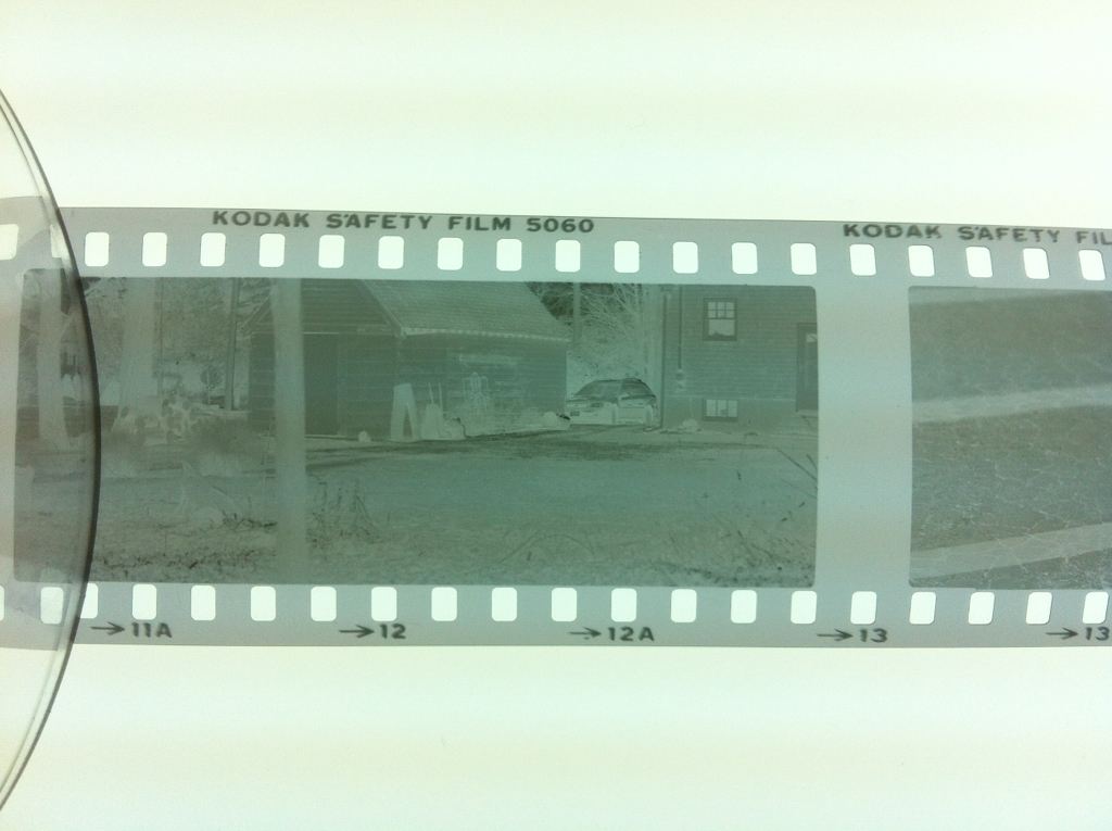

I went and dug up the last roll of Panatomic-X I shot from the 60s,
As you can see I labeled it as shooting at EI 12....
And here is a strip on my light box to show density...
That should be helpful...

Good luck, it doesn't show much on the light box but I wasn't happy with the base fog in these negs either, but it wasn't terrible..
Also, this particular batch of film I developed in DD-X and not Ilfsol 3 because it was a mixed batch of old films and I was more playing around than being specific, but I THINK my Dev time was 5 minutes... It would have been 4 in Ilfsol 3... Hope that also helps.

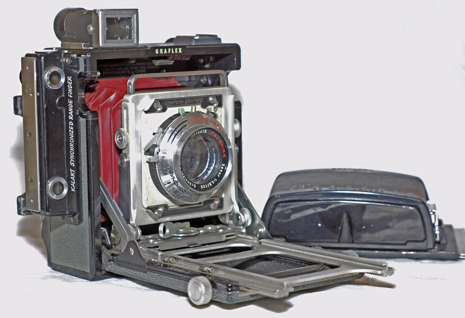

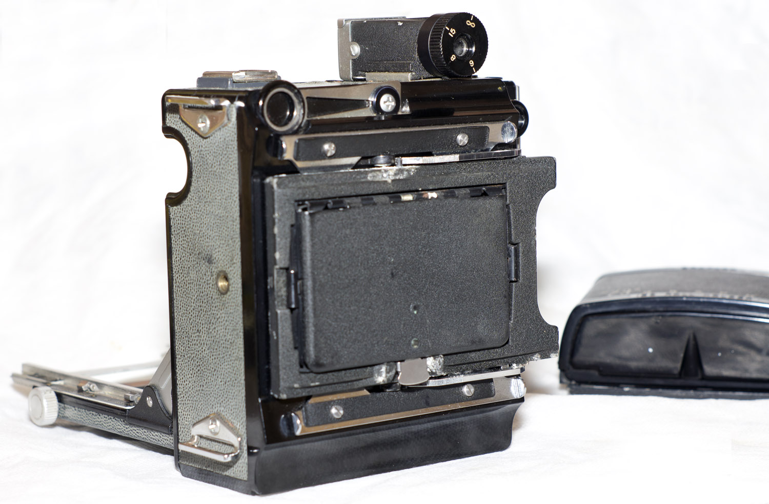

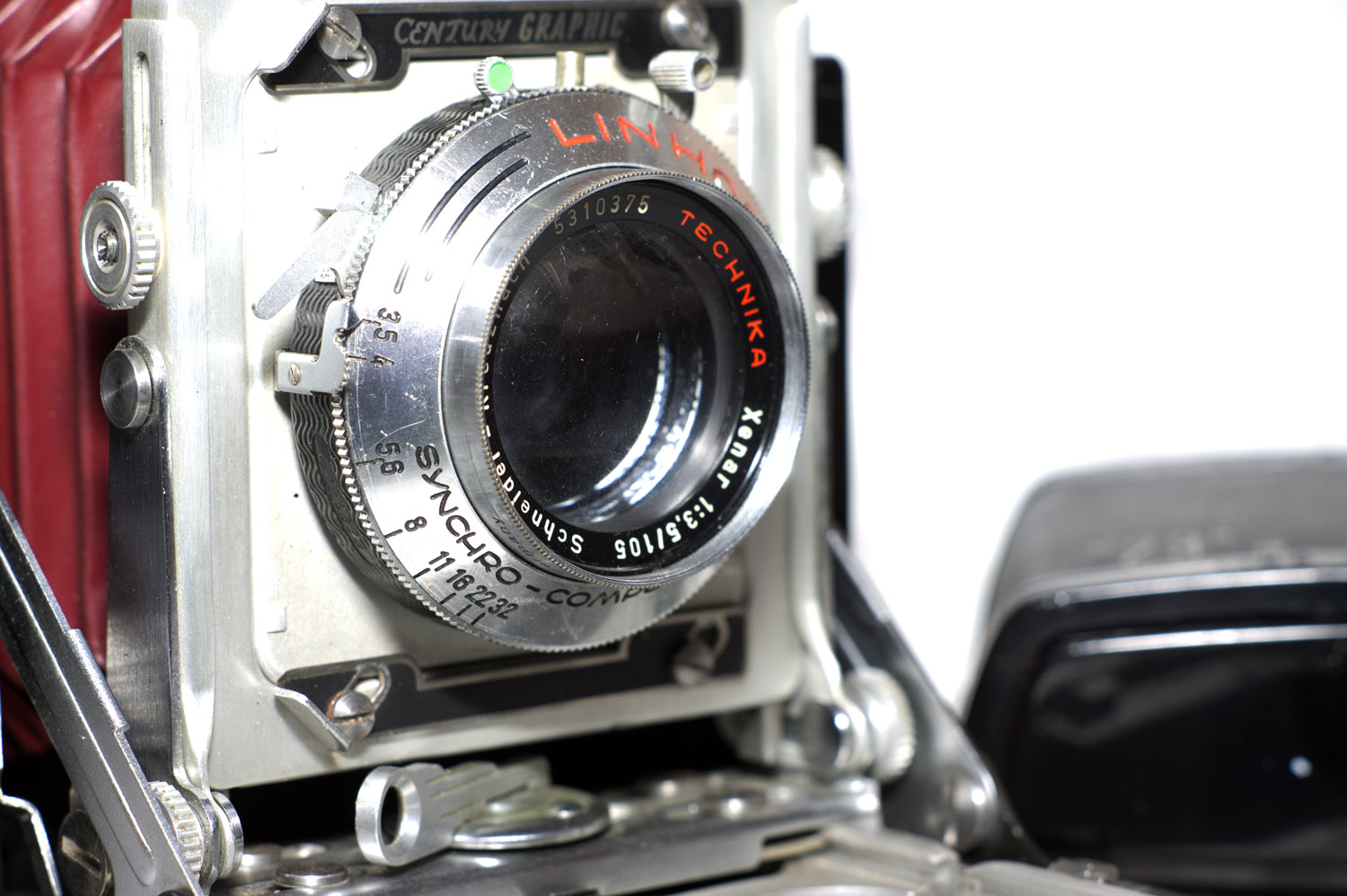

Cool, I have the 70mm back on the Century Graphic and loaded up ready to shoot, but now I've discovered the slower speeds on the shutter that's mounted on it stick open so only the top four speeds work. Oh well, I can probably get a decent test run of the 3 feet of film I put in it just using those speeds, then I'll have to give the shutter a clean. Luckily I have a 6.8/65 Angulon to fit it as well so I can swap the lenses after this test roll.
This is my Century Graphic before I put the 70mm back on it, lens is a Linhof Schneider Xenar 3.5/105.
