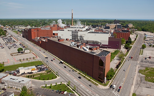

In reference to the comment about an aerial picture of Kodak Park that is in the paper video. . Here is an aerial picture of Kodak Park (from kodak.com) now called Eastman Business Park. The paper manufacturing buildings sites is now grass-covered fields are not evident. The paper buildings were located in the upper right of the buildings in front of the tan and black buildings that are Research. Unneeded buildings have been removed but EBP is still a busy place with film manufacturing other companies owning and leasing space. The large gray building on the right is B38 used to coat film. The photograph shows a small portion (my guess is 25%) of the 1200 acre site.

After careful examination I realize the aerial picture is at least 10 years old. The row of gray stacks near the horizon is no longer there. They were for acetate casting that was stopped in 2013. I have retitled the file and attached the photograph.
