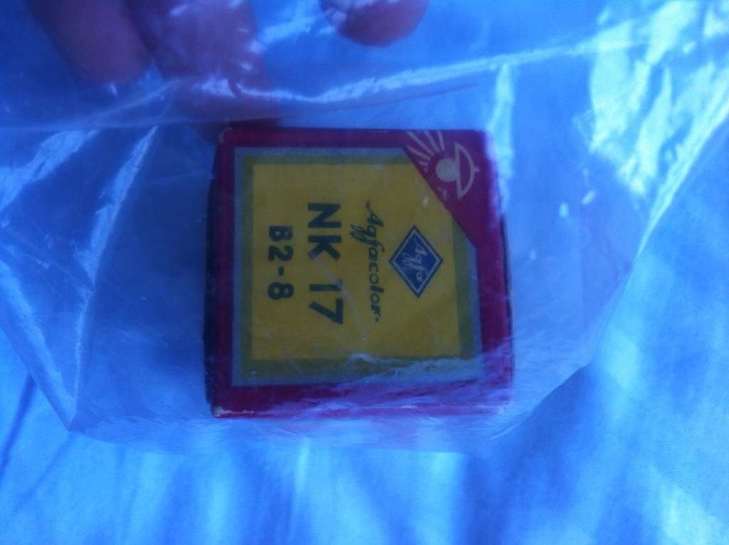

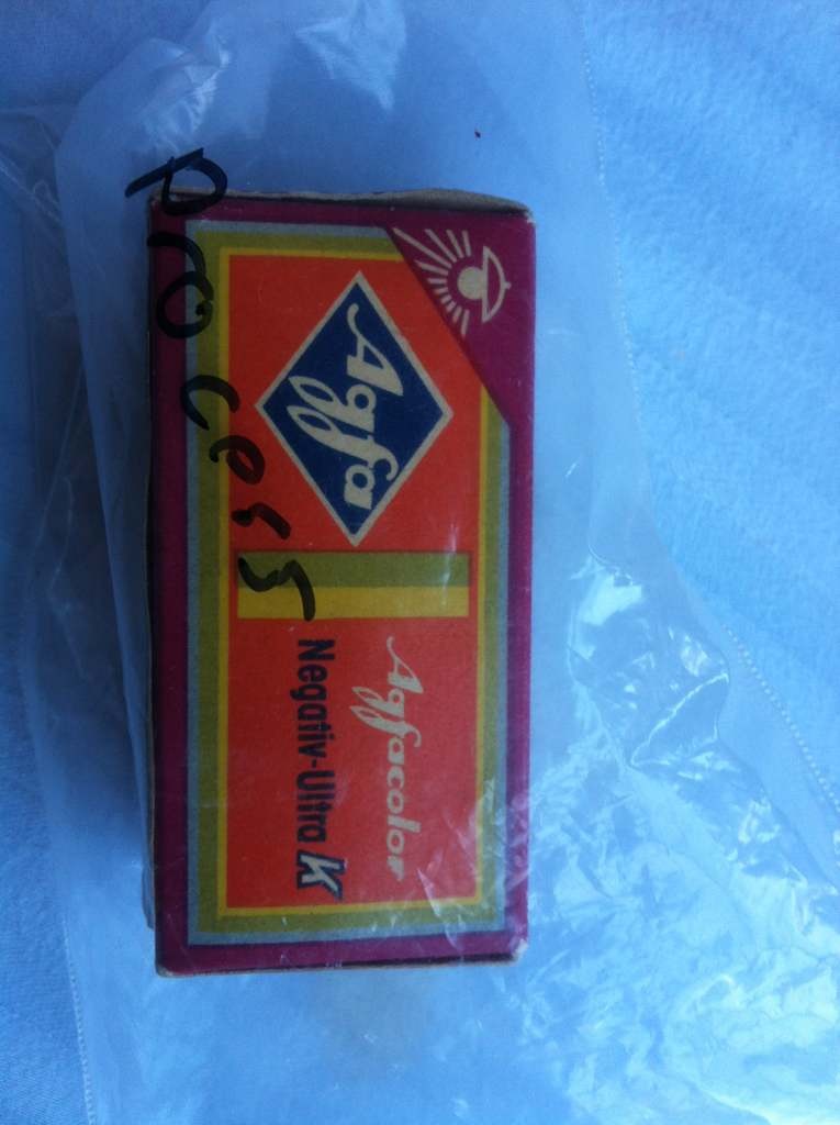

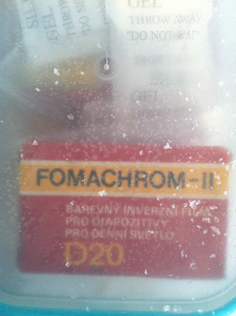

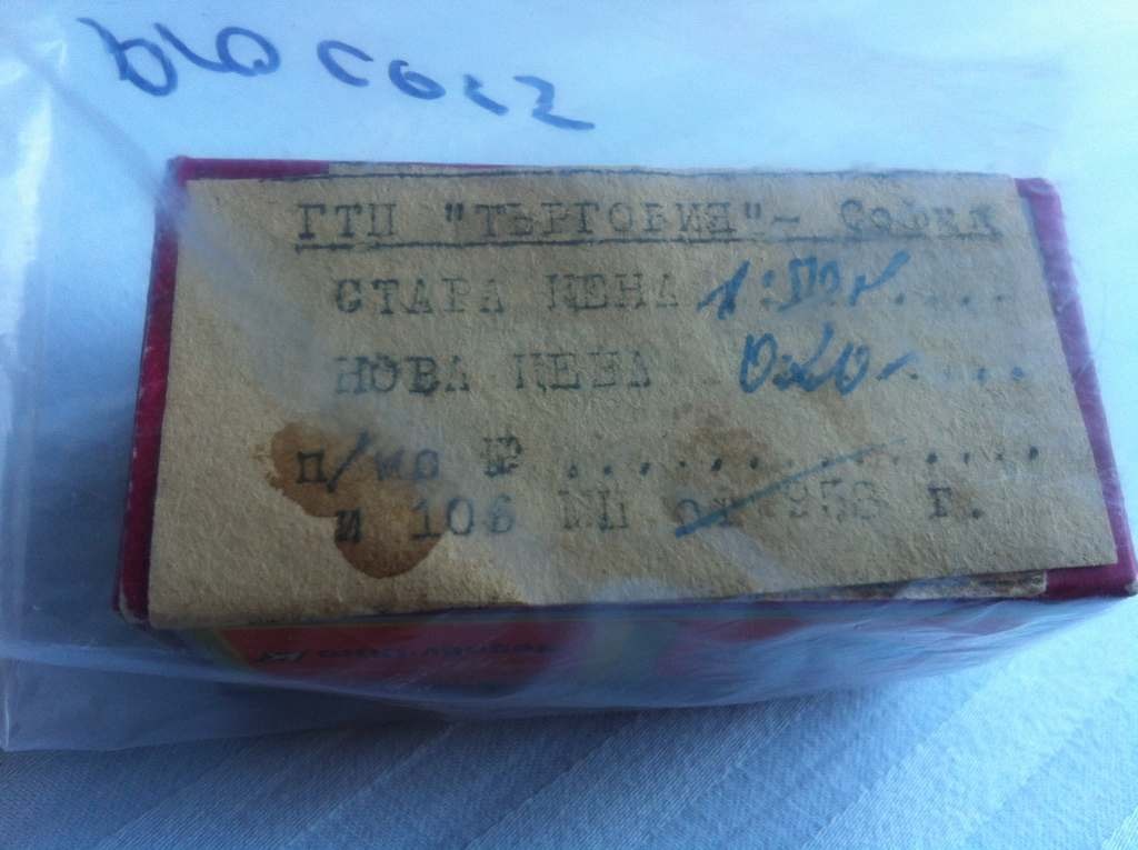

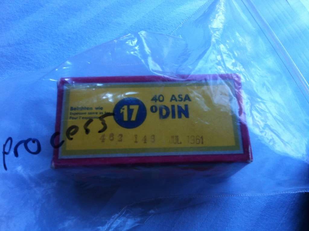

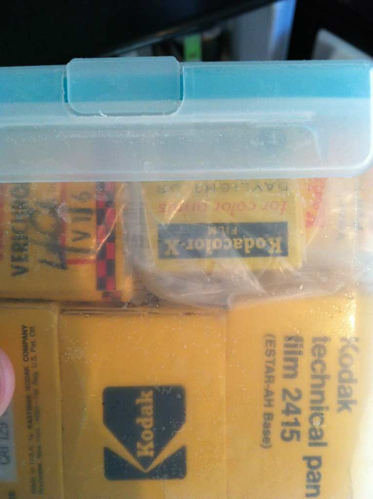

ImageUploadedByTapatalk1350823014.360422.jpgImageUploadedByTapatalk1350823027.762497.jpgImageUploadedByTapatalk1350823041.998932.jpgImageUploadedByTapatalk1350823056.600332.jpgImageUploadedByTapatalk1350823067.784914.jpgImageUploadedByTapatalk1350823077.585578.jpgImageUploadedByTapatalk1350823085.453515.jpg
Didn't want to open my sealed containers but here's a few shots, looks like it's Fomachrome-II whoops :smile:
Hope this helps!
~Stone

Reviving one of my first threads to ask... now that I've finally shot the Fomachrome II film... I noticed that unlike the others that were from the 1950's, that it was from the mid 1980's So I shot it 2 stops under for age, but I'm still unsure which process this is, if it's the 80's I would think E-6 would be fine, but it could possibly be E-4 or some Foma variant? anyone "remember"? I did a google search, and got THIS thread LOL
