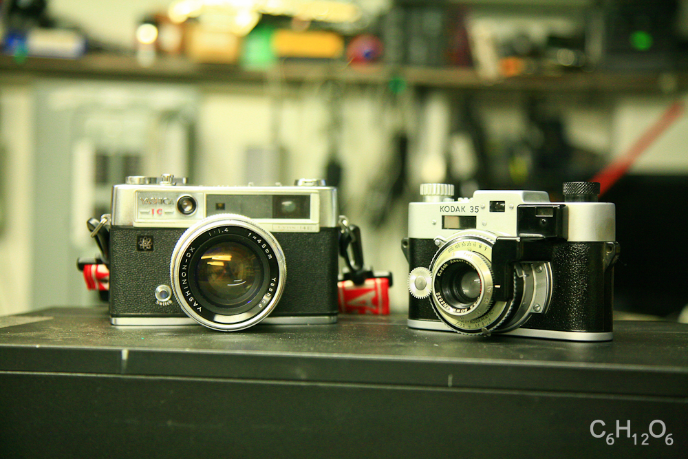

Found this poor thing sitting in a camera shop for display purposes.....traded them a busted-up Minolta XE7 with a jammed shutter for it. Winning. :laugh:
So far I'm certain everything works, I think 1/10 and 1/25 are a bit fast I need to check the shutter speeds tomorrow. It's MINTY.....but the lens is cloudy, not sure if it's the front or inside. Can I use standard glass cleaner on it? Otherwise, I love it. Test roll going in tomorrow if the shutter speeds check out. How do you rewind the film on it once it's all shot up?
The camera on the right came from the same shop a few months back, it's off to Mark Hama for a CLA and parallax adjustment soon. Use it a lot for landscapes, so infinity focus is pretty easy to find. Love the 1.4
For cleaning lenses, I always use either Isopropyl Alcohol straight out of the bottle onto a soft piece of tissue paper but this will also soak up the natural oils from you fingers and sometimes transfer them to the lens, making it worse than before, so use a surgical glove when using it this way. My preferred way is a concoction of Isopropyl Alcohol 10%, 2% photographic wetting agent (Kodak Fotoflo) and the remaining quantity to make the 100%, distilled water. This is put in a small pump action spectacle cleaner bottle and works every time.
Lift up on the wind knob, it should raise up perhaps 1/8" to 3/16" and latch in the up position (you might have to turn it slightly to get it to latch up) that should unlock the mechanism so that you can rewind the film. When your shooting you do have to push down on the little button beside the wind knob each time you start to advance the film to the next frame. Let go of the button once the knob starts turning or it might not stop when it has advanced one frame. Quirky little camera but fun:smile:

When I try to rewind it latches up and only turls like a half turn and doesnt rewind, im afraid to force it i've broken my fair share of stuff like that :sad:
Are you using the black knob on the left to rewind with? I think the shutter has to be uncocked to rewind, too. Or maybe press the silver button next to the counter... It's been a long time since I handled one. Black knob turns clockwise to rewind.

Checked the shutter speeds, 50, 100 and 200 are spot on. 25 is iffy, enough to affect exposure and 10 is no-go. B and T are fine thats all I care about. I never shoot less than 50th anyway, anything less than that is on a tripod.
about to put in the test roll, should have results this weekend.
Let us know how it works out. It might need a CLA if I recall correctly the film turning the sprocket wheel is what actually cocks the shutter and mine were very stiff and hard to turn until they had been worked over. It has been several years since I had messed with mine, guess now I'm going to have to run a few rolls through them :smile: when I did last use one was before I knew about the manual's sight (or APUG for that matter)

Test roll is in, I figured out how to cock the shutter, it needs film loaded in it.
Halfway through some Gold 200, couple of landscapes, couple of long exposures of Miami skyline at night, the time function is quite useful for this.
So far I'm in love. That Sunny-16 rule has been getting a lot of use though I've been checking it against my Canon 5D d*****l and I've been guessing the exposure correctly within a half-stop. Never had a fully-mechanical camera with no light meter.

Back from the dead!!!! Test roll came back, ALL cloudy. It's like someone was hotboxing inside my camera :laugh: and I've got it narrowed down to the front lens element. Doing a lens CLA on it as we speak.
