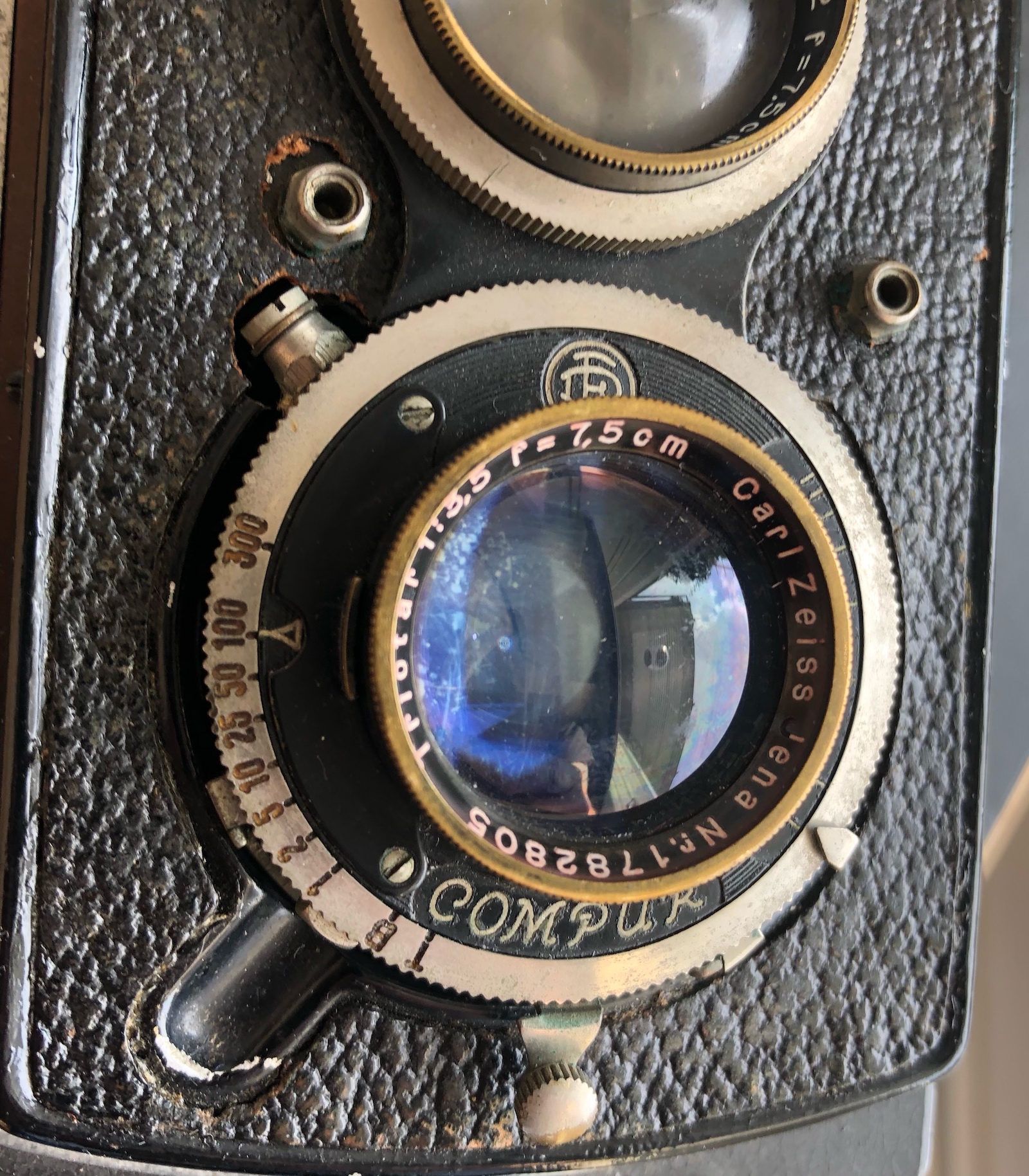

I just received an old Rolleicord Ia Mod. 1 from 1936-7. All as expected except the taking lens a CZ Triotar 4.5 is coated, both front and rear element of the front group.
I realise that this must have been a later upgrade because not even my then state-of-the-art 1937 Rolleiflex Automat v.1 w. a CZ Tessar 3.5 is coated.
Yet it seems a bit excessive to spend money to have such a relatively modest lens coated, can't have been cheap.
Does anyone here know if the Triotar 4.5 was ever sold coated from the factory?
I can see that from 1939 the Triotar 3.5 started shipping, and I would imagine that this would be the obvious candidate for coating when that became a standard feature.
Any thoughts?

No, they weren't coated at the factory, but a few owners had the lenses coated after the war and it was probably not done by Zeiss. I once had a Rolleicord II from 1938 with a coated 3,5 Triotar and it also had a PC flash contact added. This was probably done in the early 1950's.
Any thoughts?
The 3,5 Triotar came on the market much earlier than that. In fact, the 3,8 Triotar on the second model of Rolleicord from 1934 was actually a 3,5 that was aperture limited due to the size of the shutter that at the time didn't make it possible. That was changed with the Rolleicord II from 1936, that got the full 3,5 Triotar. The factory coated 3,5 Triotars were made in East Germany by Carl Zeiss Jena after the war and can be found on the last Rolleicrd II models. These lenses have a serial number above 3 million.
The Rolleicord Ia, type 3, with 4,5 Triotar was made until 1949 and these lenses were never coated to my knowledge. I think the 4,5 Triotar on the post 1945 cameras were all made before the war.

Thanks JPD!
I don't know where I had my head yesterday.
I must have been so blinded by the coating that I misread not only serial number but also that the lens in question was in fact a 7,5cm 1:3.5.
The serial number read from the taking lens, when read correctly, makes it a Rolleicord II model 1 from 1936-37 according to Rolleiclub.
This one also has added flash sync which would indicate a similar upgrade as the one you mention. I have enclosed a photo, and would be interested to know if the way the flash sync is implemented was similar to yours?
This copy has a taking lens in very good condition, given its age, and a working shutter, but the focusing lens is close to useless from fogging - and the mirror is also damaged from age. The camera came with worn finder attachment - a wireframe not shown here, which indicate that a previous owner may have used the camera with that instead.

Yes, that's the first Rolleicord II. That doesn't look like a PC contact, so I guess the modification was made before the PC connector became standard. It was certainly cheaper to "modernize" the camera with AR coating and flash sync than buying a new Rollei. My Rolleicord II, type 3, had a PC contact on the front plate, not on the shutter itself, and an accessory shoe on the side.
I have one of the same model as yours, but without any modifications:
https://live.staticflickr.com/4106/4971557849_84b164bc92.jpg
Yes, that is how mine would have looked when new - yours is beautiful.
Mine does however have a faded brown background on both name plate and the plate around the focusing know, not faded by age but by design - I think.

I have a 1940 Daagor, Goerz AM Opt, that was coated after the war for the original owner, it's not like the softer and easily damaged early Kodak blooming. I've seen a 1938 T coated CZJ 150mm Tessar and the coatings were excellent identical to my 1953/4 CZJ 150mm Tessar.
As Ag has said coatings were used during WWII often for military optics. T., T & H (Cooke) were quite advanced in their coatings but they were deemed a military secret.

I wonder if that may actually be "blooming" on the taking lens? I've had more than a few folders from the 30's, and some of them had that. It acted as a form of coating anyway according to what I've read. This is what gave people the idea of coating the optics in the first place according to some.
All I know is that the Triotar is my very favorite medium format lens. Put a hood on it w/ a yellow filter, load the camera w/ Tri-X, it's a pretty magical thing, especially wide open at close distance and w/ head and shoulder portraits. You can use just the center of the neg to crop it down for almost head shots w/ some pretty neat bokeh. The one below from a 1938 Rolleicord was full frame though.
If it was natural blooming which i have seen on CZJ lenses it should be visible on the viewing lens as well.
But there's someting that smells fishy here, why the Gold Rim Dagor look to both lenses, I suspect that the lens was coated well after WWII, the whole camera has been timkered with.
It's faded, but the brown colour can be beautiful if it's even. I'm not sure about the process they used, I've read that they are etched, but not if they were anodized as well.
"Blooming" is very common on the uncoated Triotar, but it has a rainbow sheen.
The Triotar is indeed a very good triplet, with a character of its own. Longer versions were used as "tele" for small format cameras, and since only the very center of the image circle was used, these lenses vere excellent despite only having three elements. (I don't have any of those, but there are many photos taken with them on Flickr).
Ian
The gold rim is just brassing. It looks more even in the photo than it does in real life. The added flash sync looks strange though, I have no idea how it would have worked - of course there is the possibility that it served a completely different purpose.
