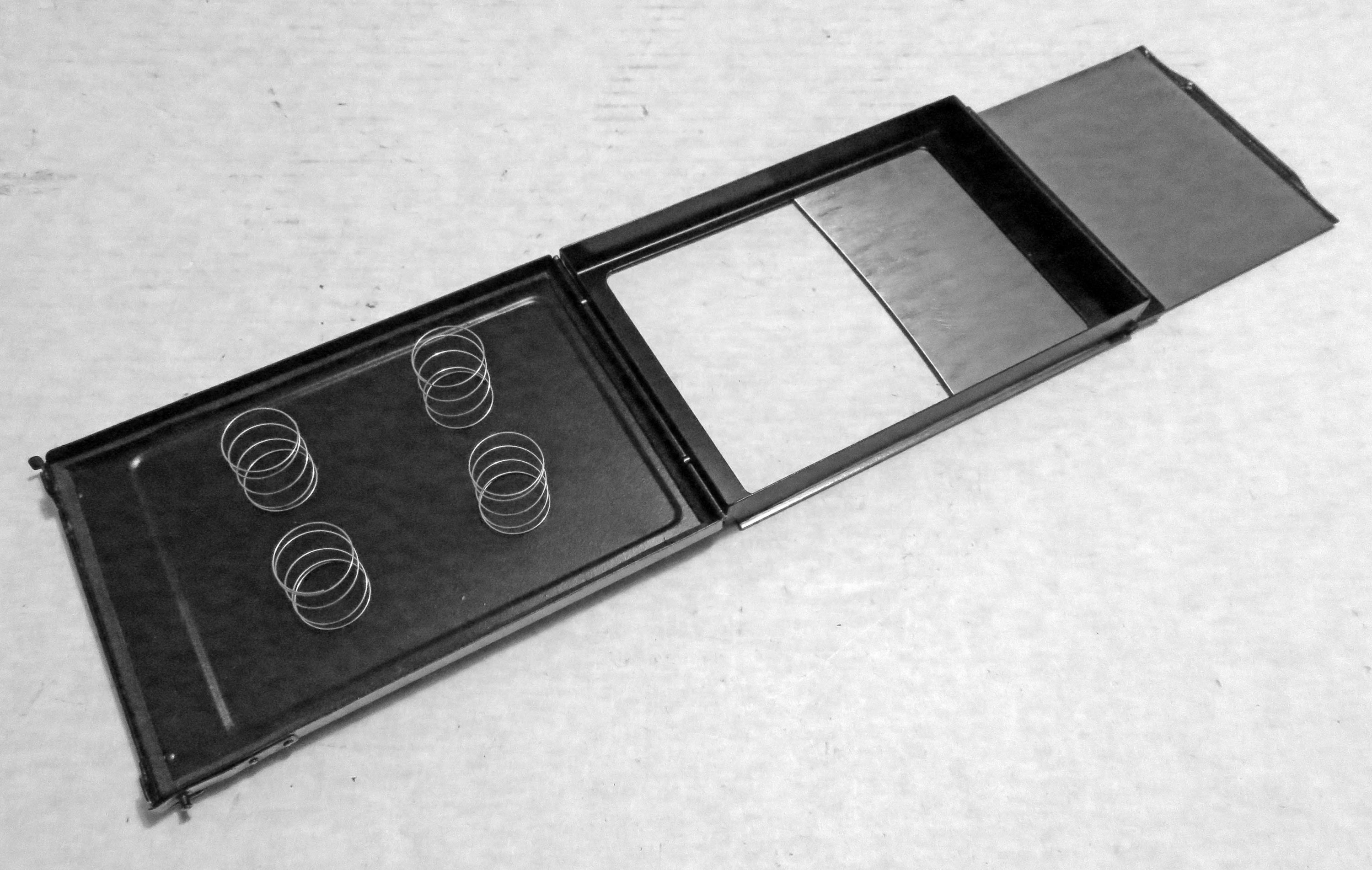

I have already plugged the hole in the side with a piece of sheet material from the dark slide of a 4 x 5 film holder. I have a 60mm x 85mm aluminum pressure plate on order that will be attached to four springs to apply pressure to the glass plate (see photo). All I need are some internal rails to keep the plate from moving laterally and I think I'm set. Thanks for the help and your link for access to some sensitized plates. Matt

Here is the solution I came up with. I fashioned some plastic spring clips from a piece of circular trash can and attached them to the lid of the film pack adapter. When you close the lid it applies gentle pressure to the glass plate inside, keeping it from moving. I have also glued some rails on the focal plane side to keep the glass plate from sliding left or right. Then I applied foam to the inside of the lid so it makes a light tight seal when closed. Hopefully this will work.
