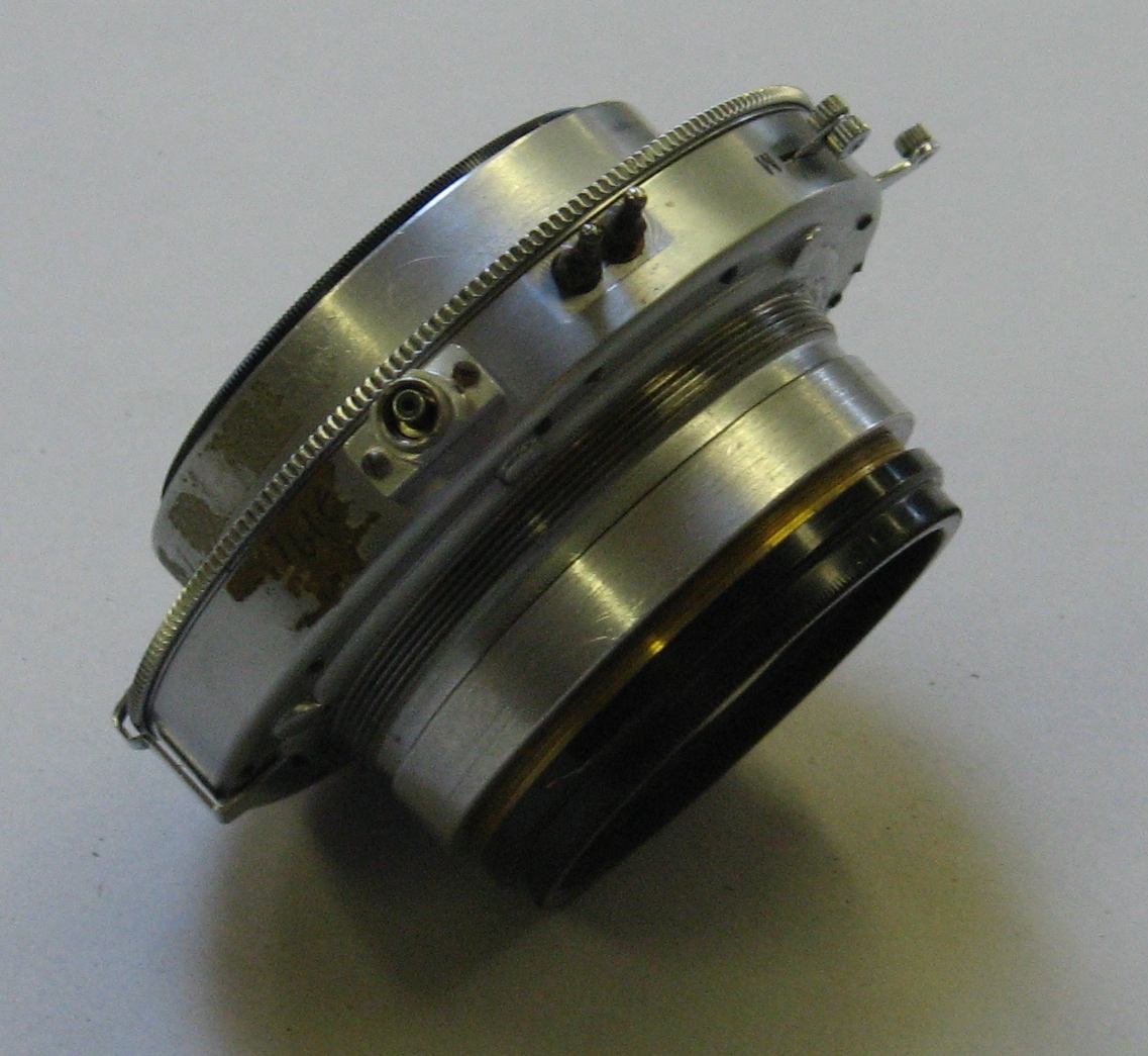

I bought a lovely 19" red dot APO Artar at the Photographica show yesterday and I need to check something. It came mounted in a shutter, using aluminum spacers that were obviously professionally made. The rear element, however, does not screw all the way down to seat cleanly in the spacer. Before I redo the spacer, or the threads in the element, which seem to be very slightly out of round (they don't fit the front spacer either, even though the front element screws cleanly into either front or back) I thought I'd ask someone who has this lens in a barrel to measure the barrel length and tell me what the proper spacing on this should be. Neither the element nor the spacer barrel show any signs of abuse or damage.
Anyone got one of these things and a good measuring device - or a spec sheet?

Whitey:
My notes say:
C. P. Goerz Am Opt Co Apochromat [RD] Artar 19 In F:11 No 801033
Barrel: 1.865"
Front to Iris: 1.133"
Front Thread: 2.310 - 2.339" x 36 TPI
Rear Thread: 2.322 - 2.351" x 36 TPI
Flange: 2.482 - 2.514" x 26 TPI
As you can see, in my example, the rear thread is about a hundredth of an inch larger than the front.

Here are some quick pics. The shutter it's in is an Alphax, probably #4, I haven't checked the measurements and it's not tagged as to model number. The difference in the thread size could be the problem, though as I said, it seems to have been a professional job, and I can't imagine the machinist simply saying, "oh, well... good enough."
Then again, maybe it's not a pro-job, at least not a purpose-made set of spacer rings. Maybe the guy had them made for another lens and faked it after something went south on that one. It was originally from an estate sale, so the owner was not available for comment. I got a very good price on some nice glass and a good, if limited, shutter. I'm going to make it work. I have a retired tool designer/engineer/machinist for a brother-in law. He'll help me now that I have the specs. problem.jpgwhole.jpg

Good point. I have actually measured the various parts at this point, and the guess of a professional adaptation was wrong on many points. Since my calipers measured the threads exactly as they were specified in Charley's post, I am making the assumption (there I go again!) that the spacing should be the same as the barrel length. If so, the rear element is not too far back, but too close... by over .05". If this is right, I can jury-rig the spacing quite easily with washers. More testing necessary– maybe even some real photography! As I said, good glass, decent shutter, good price – I'll live with it.

OK. Now that I have had a chance to do a couple of test shots– wide open at f11, Tmax 320, Sprint dev.– 5 copies of a test pattern pinned to the wall in a cross pattern, so that the papers fill the frame. I can say that any difference between how the elements were spaced when I bought the lens and the specified distance from the above post is invisible on the negative using an 8x loupe - right to the corners. Since I will be contact printing anything I shoot with this lens, that's more than good enough for me.
Damn, this thing is sharp! I'm used to shooting with old brassies and the occasional magnifying glass and such. I might have to up my game in terms of focusing... . The thing is that I bought it on a whim, being flush with the money from selling off some 35mm gear. It doesn't fit my "travel" 8x10- needs too much bellows draw for the Korona Home Portrait. I may put it up for trade for something in the 12-14 inch range in shutter, but it is amazing at long portrait range on the Studio Master.
