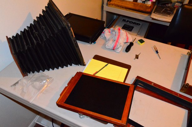

Well I brought the Empire home and it has a lot of issues
It was difficult to evaluate the camera at the McDonald meeting place. But this evening I looked at it closely.

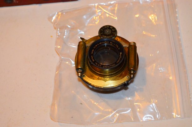

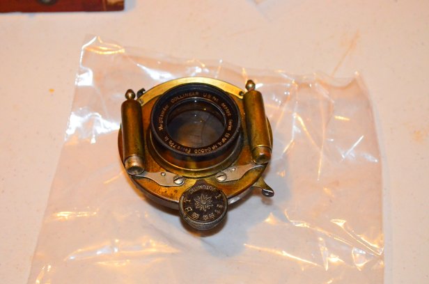

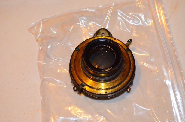

The lens is a Voigtlander COLLINEAR U.S. Pat. 567326 Series III No 64505 Focus 7 7/8 in. The rear lens element has the same No 64505 number. I see two very tiny air bubbles in the front glass, 1 very tiny bubble in the rear glass, but other than that, the glass is rather clean and no scratches. Does not look coated (not surprised). It seems to focus the light bulb (above me) fine on the table.
The lens is in a Wollensak Opt Co. shutter gizmo. It has two pistons. One seems to actuate (by air I guess) the shutter, the other was frozen but I got it unstuck. There is a dial on top that says AUTOMATIC with numbers 1 1/2 1/5 1/25 1/50 1/100 B and T. The shutter seems to work in B and for all of the timed values, the shutter seems to have one constant speed no matter where it is set. The diaphram seems to work fine. It has f-stops of 64 45 32 22 16 11 7.7 and that's all the numbers I see, but opens up a tad more. There is a PAT.FEB.6.1900 on the shutter release side and PAT.JULY23.1901 on the other piston side.
The bellows look original and at first glance, look pretty good. But they were advertised as being light tight - not even close. I hear there are ways to fix that but I've never done it.

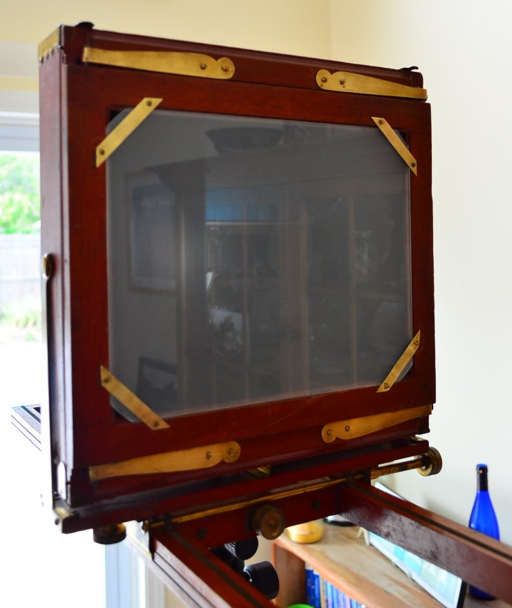

The original ground glass was broken long ago but the seller had another made and it looks like it should work. (I have the camera in pieces so I have not yet tried to get an image on it.

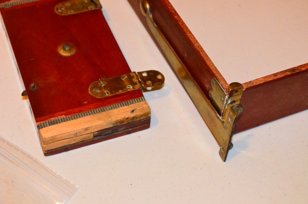

Wood is cracked in a number of places and one piece is completely broken but still there and I can glue it.
I got 2 plastic/modern film holders and 1 wood one that looks old but the wood is in nice shape. The hinge on it is broken and one side has a sheet of film still in it that I exposed the first inch. Not sure if there is anything viable over the rest of it.
The rear standard has, I guess it called, the "double" swing (instead of a single one I read in some old online catalog). (It seems to move just like my 4x5) Also rear tilt. The front standard only has rise/fall.
There is a front dropdown bed (with a long crack that can be easily glued), and a separate rear bed that looks fine. A chunk of the bed was replaced by some unfinished wood but seems to function fine.
So there you have it. Not a show piece (and was not advertised as such) and my goal was never that, but for a viable field camera (this was advertised as perfect working condition). I know it's 117 years old and I am probably being way too critical for something like that. I did not pay an arm and a leg for it.
What should I do? It would be neat to get such an old girl working again but is it worth the trouble? Should I try to get my money back and put it towards a truly working camera. Thoughts?

Here are some shots of what I mentioned above...

All in all an interesting bit of kit. I'd find someone who really knows how to work on those pneumatic shutters and send it off to be cleaned and adjusted - they may not be terribly accurate, but they're very reliable and consistent when in good working order. I have one on an 11x14 camera I have that while I'm pretty sure the speeds are all a bit longer than advertised on the dial, each speed seems to be 1/2 or 2x the time of the next one, which is what really counts. Which is pretty remarkable when you think of the lens being over 100 years old and still in original condition. As to air bubbles in the glass, those were seen as marks of quality in the glass of that time - a byproduct of the manufacturing process of good glass. Don't worry about them. I've got a couple in my Voigtlander Heliar and I can say from personal experience that they have NO adverse effect whatever on the image.
For fixing the bellows, there are a number of options. So long as they are in one piece, with no major rips or tears, just pinholes in the corners and such, you can get some black liquid rubber goop to paint on them that will seal them (I know Bostick & Sullivan carries it - http://www.bostick-sullivan.com/cart/product.php?productid=6&cat=0&page=1, others may do so as well). Another option is bookbinders tape, which you can find at most major art supply stores. It is a heavy-duty black cloth tape, designed to be flexible and withstand repeated bending and stretching. I would limit the use of the tape however (think small rips in the sides, or along seams, not corners) because eventually it builds up and makes the bellows too thick to collapse entirely within the originally designed space.

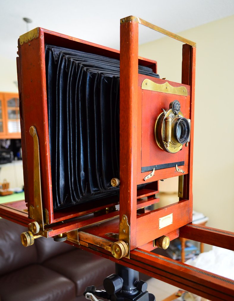

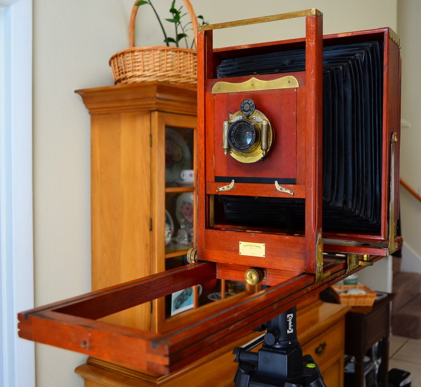

I decided to work on it - a lot
Attached are some pic's (did not compose them well - sorry) of the Empire after I cleaned and fixed it up somewhat. I glued broken pieces, re-attached the lens mount correctly, added some tape where the lens board edge (5" on a side) was partially broken to seal out a light leak, and waxed it up a little. Facing out to the backyard, I focused the view on the ground glass and stuck a cloth over my head and slightly tilted the rear standard. So far so good I say.
The short focal length of the lens gives an impressive wide angle view and really collapses the bellows. I did not see any glaring light leaks when I stuck my face in the back (after removing the ground glass unit). That unit fits either in landscape or portrait orientation.
I'm guessing the shutter fires around 1/50 sec.-ish. Seems slightly slower than 1/60 but I could be way off. The only other "speed" would be to put on bulb and manually fire long exposures. I cannot figure out how to do that via a air tube as fiddling around with that shutter - lifting pistons up/down does not appear to open the shutter and close it in a up/down motion. But manually operating the shutter works fine in bulb. Not sure how I can do that without wiggling the whole thing.

Usually the piston on the left as you look at the lens is the actuator, and the one on the right is the piston that regulates the speed. Sounds like the shutter needs to go for a good CLA. You could probably clean it yourself, but don't lubricate the pistons. Lubricating oil just interferes with the proper operation and will eventually gum the things up. Make sure if you send it off to someone to do a CLA that they understand this and have worked on these kinds of shutters before.
Two23
Jul 4, 2010
660
South Dakota
8x10 Format
The shutter is very similar to a Unicom, the most common of that era. Someone might suggest cleaning it with lighter fluid, but don't do that! It might dissolve the shutter blades. Air bubble in lens were very common then. You can probably unscrew the elements and clean them, but be careful to not crossthread when putting back together. Check the bellows to see if light tight by going in a dark room and running a small flashlight through them. Look for tiny holes in the corners of the bellows especially. Not sure what holders that camera will use, might not be the standard type of today. The Kodak cameras were built for heavy commercial use. YOu could make a second lens board to put another lens on. I"m having one made for my 1880s half plate Watson & Son tailboard that can hold my lenses mounted on technical type 4x5 boards.

Oh no! - Well the shutter/diaphram is now blown
Kent,
I heard about the lighter fluid and I wish I had read your post before... yep... it DID melt the blades. So it's toasted. Crud. Well... I guess I no longer need to worry about getting that to work anymore. The lens is still very fine but now has no shutter to speak of.
Now what?
Should I even attempt to find a working shutter for the lens?
Or chuck the lens and just hunt for another (perhaps more mordern) setup? I don't know much about assembling a working lens & board. I do know the board is 5" square. Be convenient if I could swap between my Calumet CC-400 (believe 4" square) and this one. Is the Voigtlander worth anything now?
Or maybe unload this Empire and look for a workhorse 8x10. I was not planning on restoring this camera. Just want a working 8x10.
