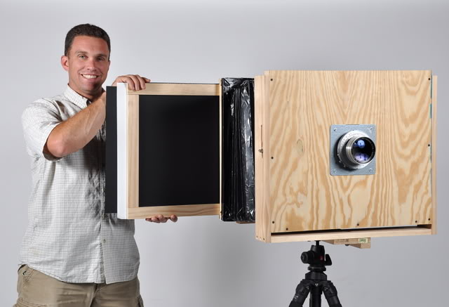

Wollaston meniscus lenses? In terms of image quality you will be better off just enlarging 4x5" negatives to 16x20" unless you are after some special effects. The difficult elements of 16x20 camera construction from scratch are the film holders and the ground glass back. For example you will need to figure which t-distance you want to use and which exact film dimensions to use for the film holders, if you are going to make these yourself. The rest does not require as much skill to construct (front and rear standards, tripod, bellows, lens).
(Nathan Appel's 16x10)
