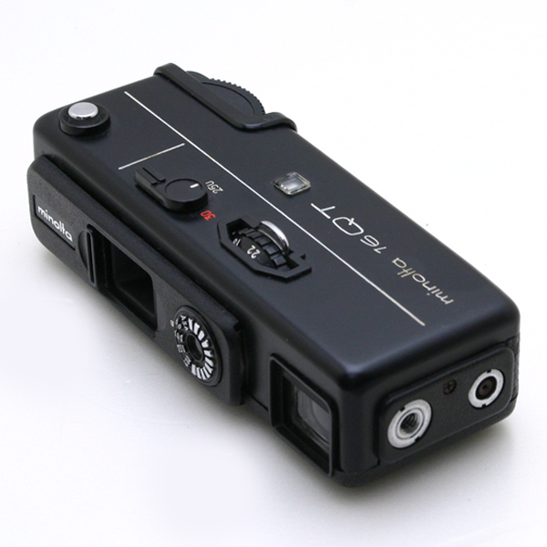

I'd recommend Minolta 16 series. All take the same cartridges. I think I am like many out there that own a bunch of these cameras. No single camera has all the best components.
16QT = last of the generation, has biggest image area but is mostly plastic. Has focus and built-in meter but only 2 shutter speeds
16MG = next-to last camera. Has the big image area and more shutter speeds but no focus. More metal in the construction.
16 II = fully metal camera with fully adjustable f-stop and shutter speed. Focuses with interchangeable diopter lenses. Smaller image area (not much bigger than Minox).
16 I = just like above but with less shutter speeds and f-stops. Smaller lens, less elements and uses different set of interchangeable filters.
16P = Pretty basic. May be fun to use if you get one for free.
