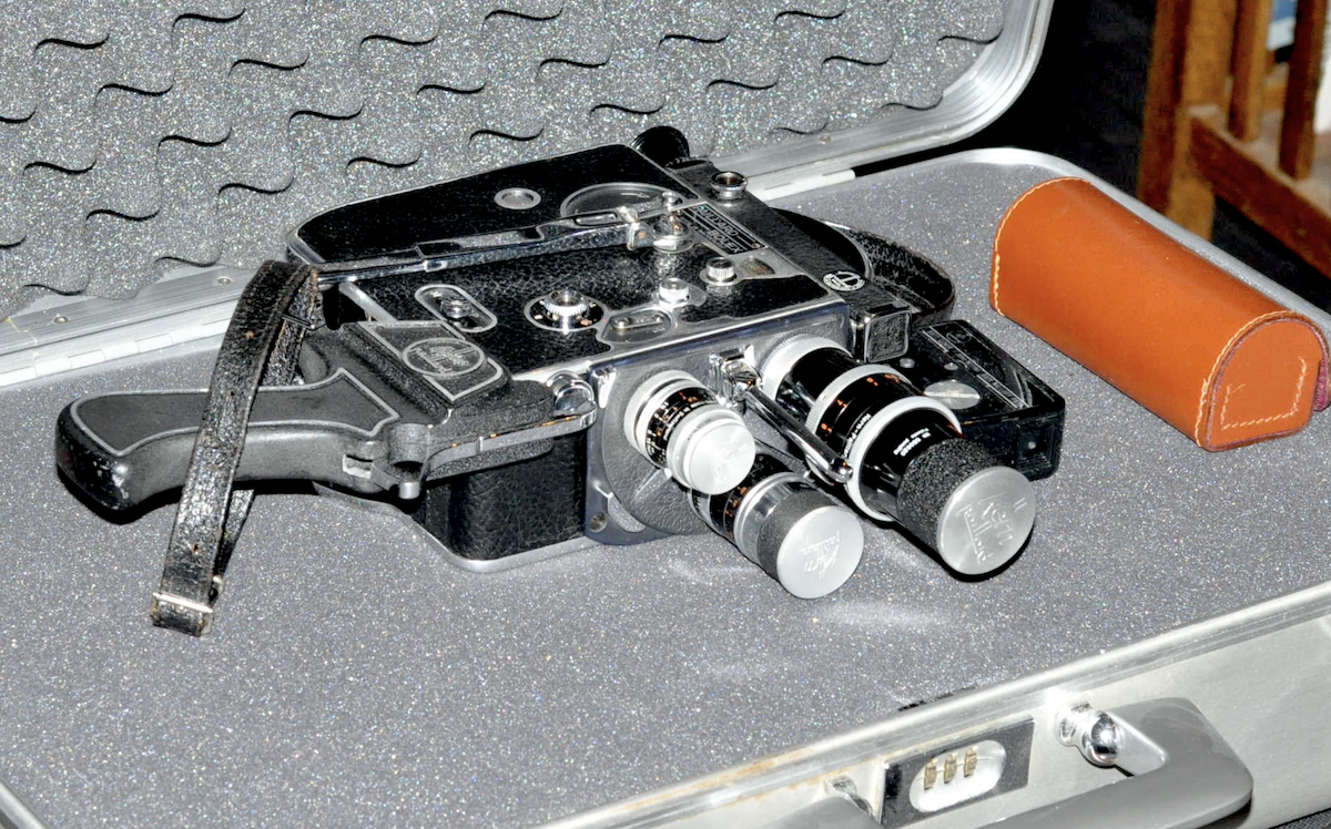

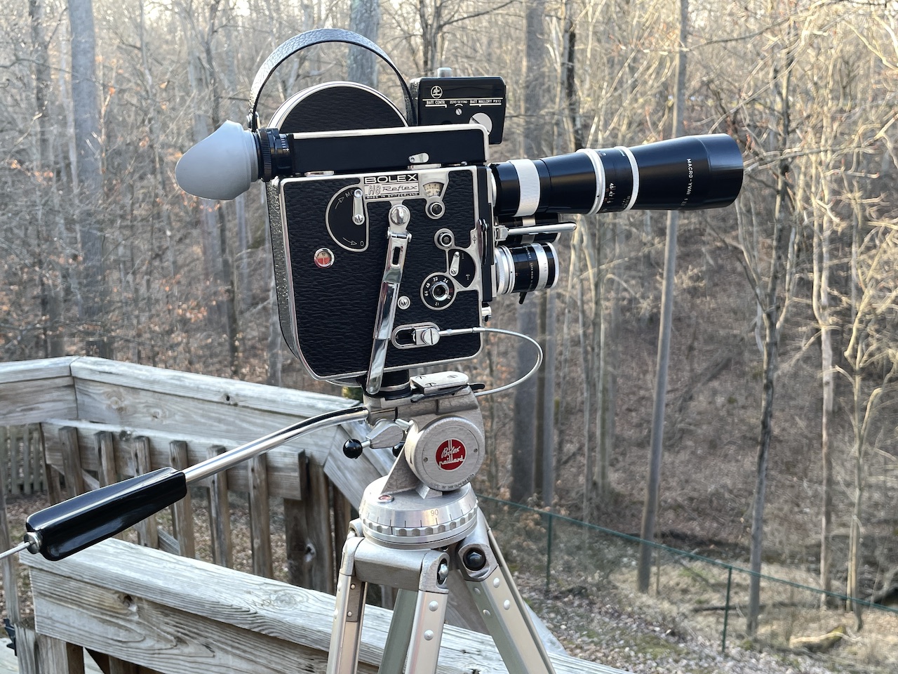

Yea baby! On 8mm format this is 12X magnification!
Macro-Yvar 150mm f3.3. Focus down to 6 feet.
35mm film equivalent is about 1000mm!
Realize the diagonal of regular 8mm film format is about HALF that of Minox! So, imagine a lens twice this size on a Minox!

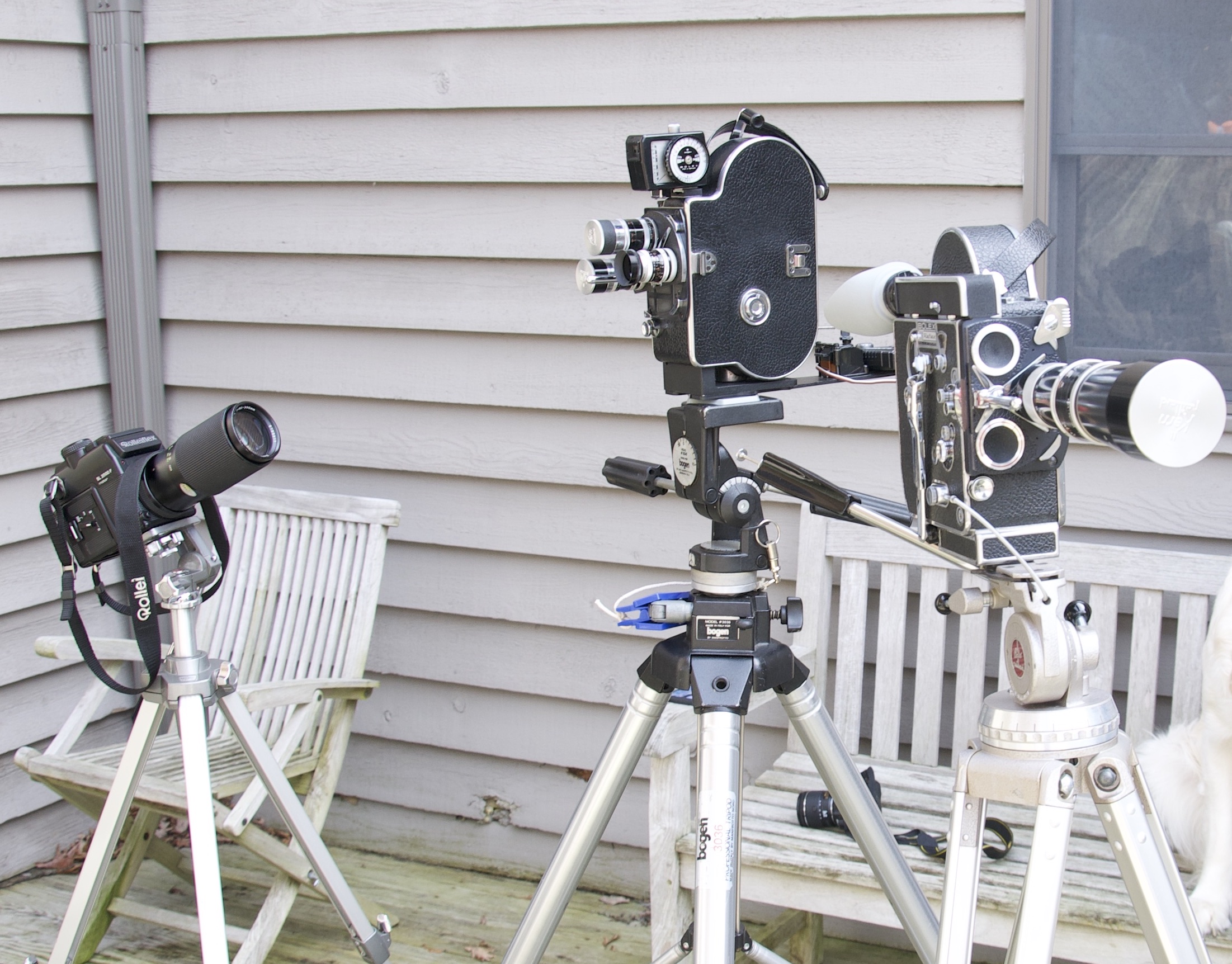

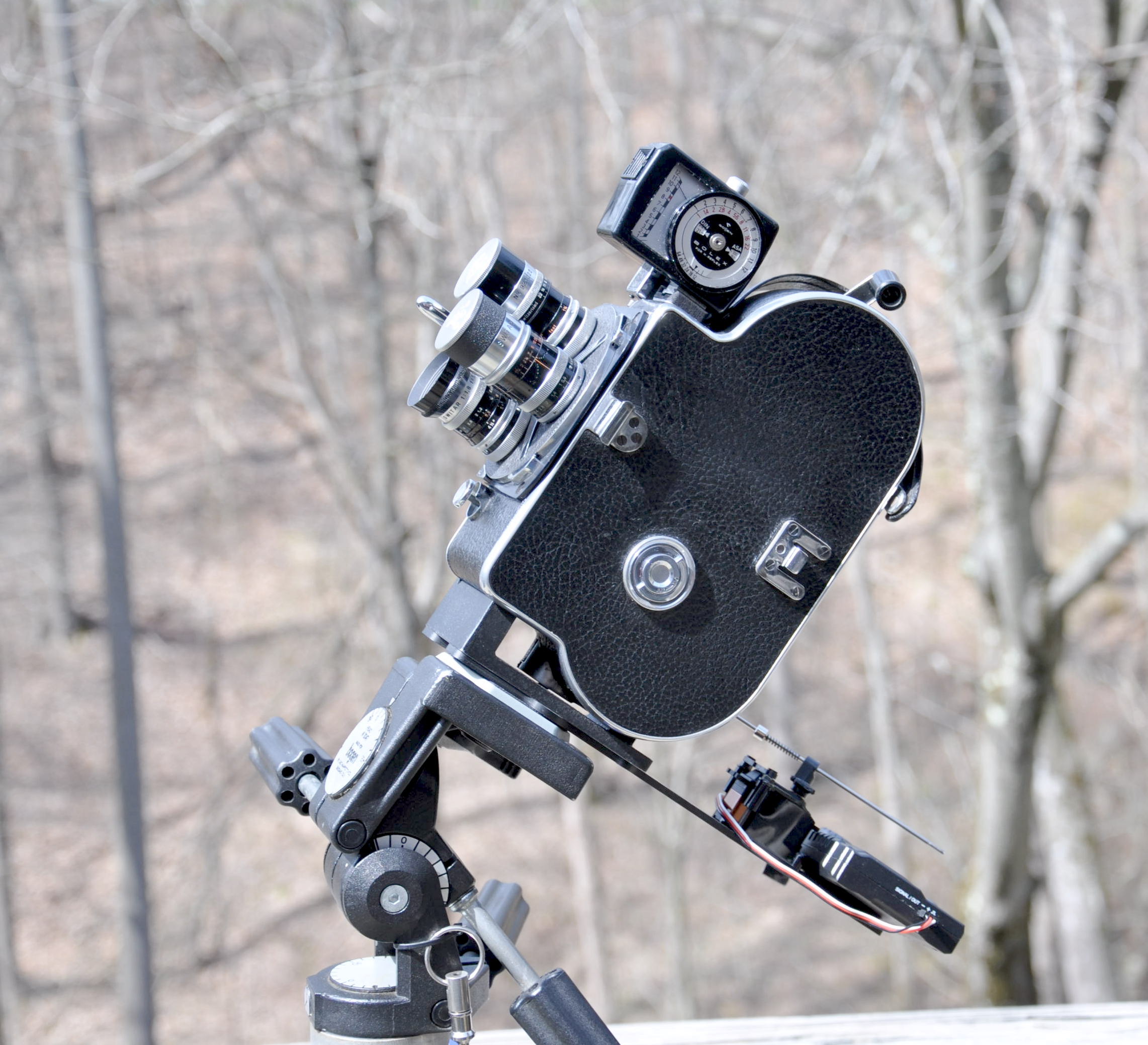

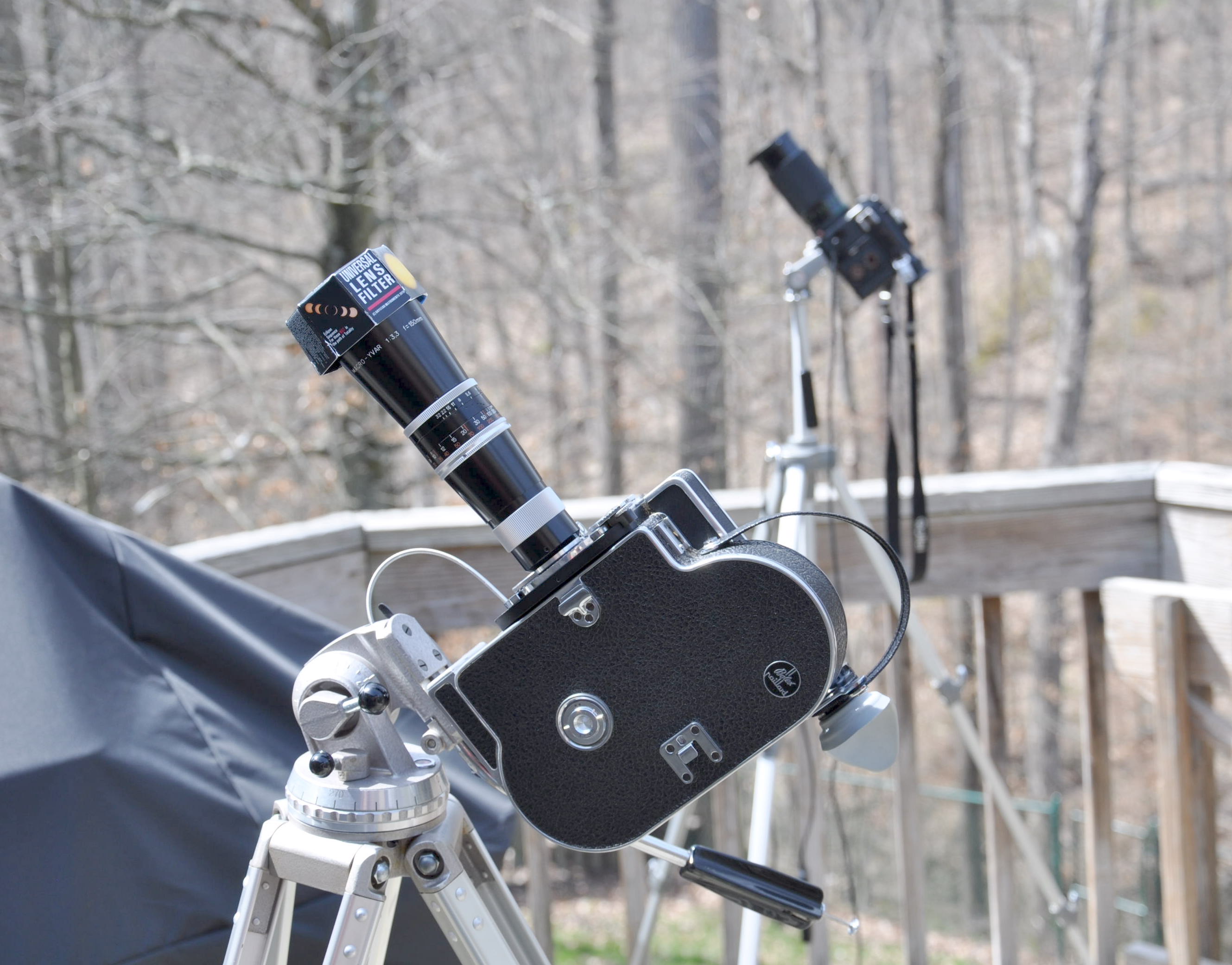

Morning of the eclipse; getting everytihng ready.
The Rolleflex was nice because of the waist-level finder and 33ft shutter release cable.
One camera had the 150mm lens and the other used a 5.5mm wide angle lens and was hooked to an intervalometer. Exposing one frame every ten seconds.
The image with the 150mm lens was so dim, I needed to make a spotting scope with the zoom viewfinder.

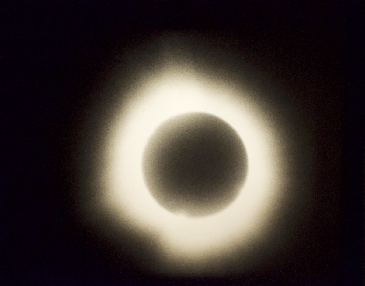

I got my film from the eclipse back today. This is a photo of the projection screen.
Again this is 8mm with a 150mm lens.
I'll try to post some movie too.
Pretty amazing how the sun first becomes totally black (with the filter in place), but it is still too bright, even for f22 with the filter off.
What happens in the move is that when the sliver of sun disappeared, I took the filter off, but it was still too bright. So I quickly put the filter back in place, stopped down to f22 and took the filter off again. That gave me the brief Baily's beads sequence. After that I opened back up to f4 for the total.

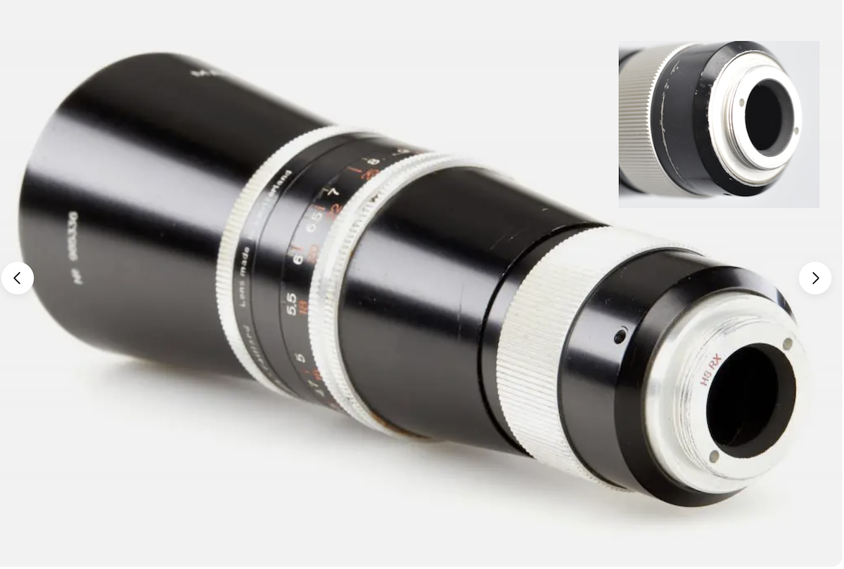

Nice job! Isn’t that lens meant for an H16? I assume it focuses past infinity on on H8, is that correct? I have an H8 and H8 Rex 4, great cameras.
You know your lenses. Yes it is essentially an H16 lens, but they made some of them with an extended 2.2mm longer mount for the H8 RX as you can see in the picture. Otherwise it is identical to the H16 lens. There is also a Yvar 100mm and 75mm with the H8 RX mount too, but like this 150mm, they are extremely rare. If you ever see one; buy it!
