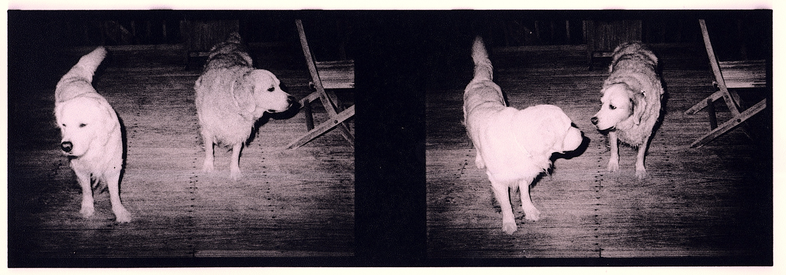

240 seconds. A little better, but this negative was a little dense. This is because the Atoron Electro ASA only goes to 200, or maybe just a little past if the wheel is turned all the way. (Ilford HP5 film).

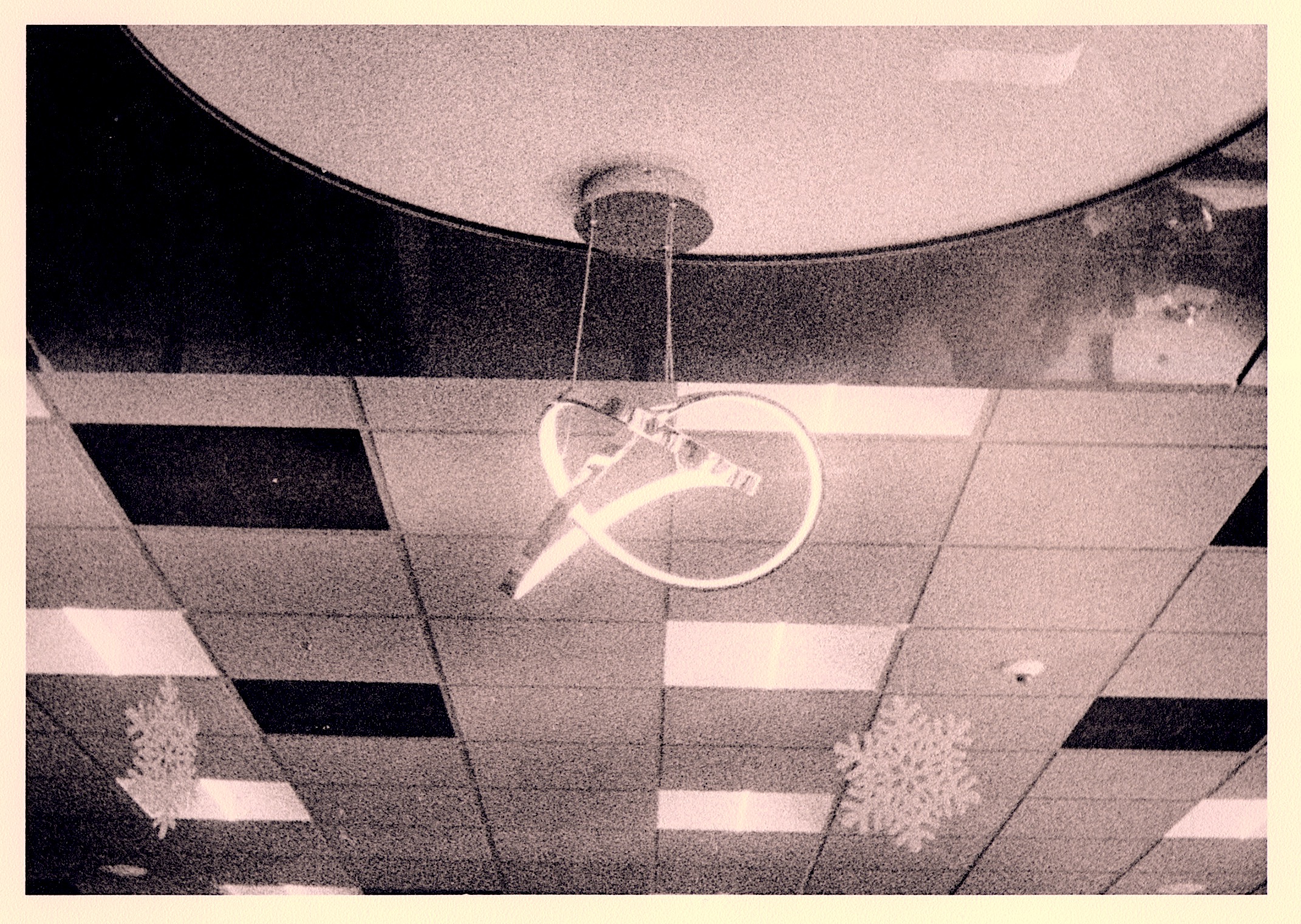

This is 240 seconds with a thinner negative from the Minox LX, HP5 (which has an ASA dial that goes to 400).
Forte, 5x7 RC MG 2002 vintage.
Actually not bad.

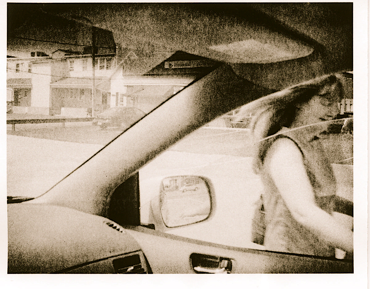

I also had some contemporary Lith paper; Foma Warmtone FB. Same negative and exposure as above.
I'm very happy with that. Almost as good as the Lith prints I made 20 years ago on fresh Forte FB. Better than the old Forte RC.
ic-racer
ic-racer
Feb 25, 2007
16,724
USA
Comparison of a print made 20 years ago on fresh Forte FB (Minox LX; Minopan 200).
I don't think there is any paper available today that looks like this. That is why my enthusiasm for Lith printing waned all these years.
ic-racer
ic-racer
Feb 25, 2007
16,724
USA
These last few came out OK, so I'll buy some more paper to use up the developer.
