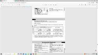

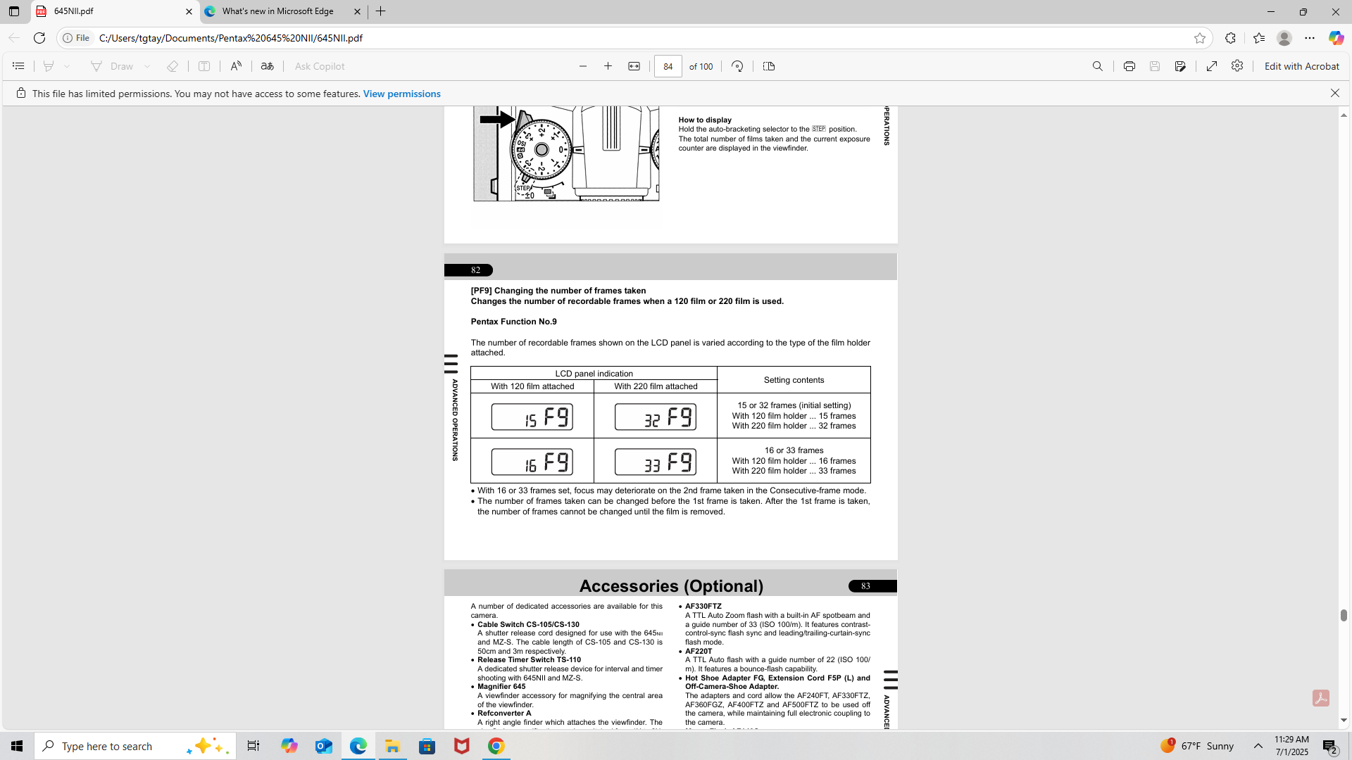

I assume that all red window cameras are 16 shot because thats what is on the backing paper. I've read that the last film Pentax 645 had a system item where you could switch between 15 or 16, and it would adjust the spacing accordingly.
