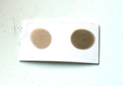

I mixed up 5L of Xtol in november 2009, I have two bottles left one that has been left half full since last november seems to have died, the other one did eventually turn a peice of film black, I did the paper test and it did work and become warm tones when fixed, bit I'm not sure if it's what I'd call dark, does this look right?

15 months is a long time for Xtol. I think the best I've seen so far is a claim for about 9 months. It would be nice to know what its limit is if it is stored in full containers.
Can you risk a couple of frames in a clip test? It looks like it won't be successful but it might be nice to see what the outcome is

First the paper test is only valid if you have a fresh stock of Xtol that you tested with the same paper for comparison. (see details on the link you sent)
Second I have stored Xtol the way it says to in the link you provided (glass bottles etc). I have had it last over 2 years that way. I used it up before it went bad so it may have lasted longer.
Third, It looks like your Xtol is bad to me as the paper is not as strong black as I would think it should be.
Make up a fresh batch and test them side by side.
Xtol is really cheap. You can buy 5L of it for the price of 2 rolls of film.
