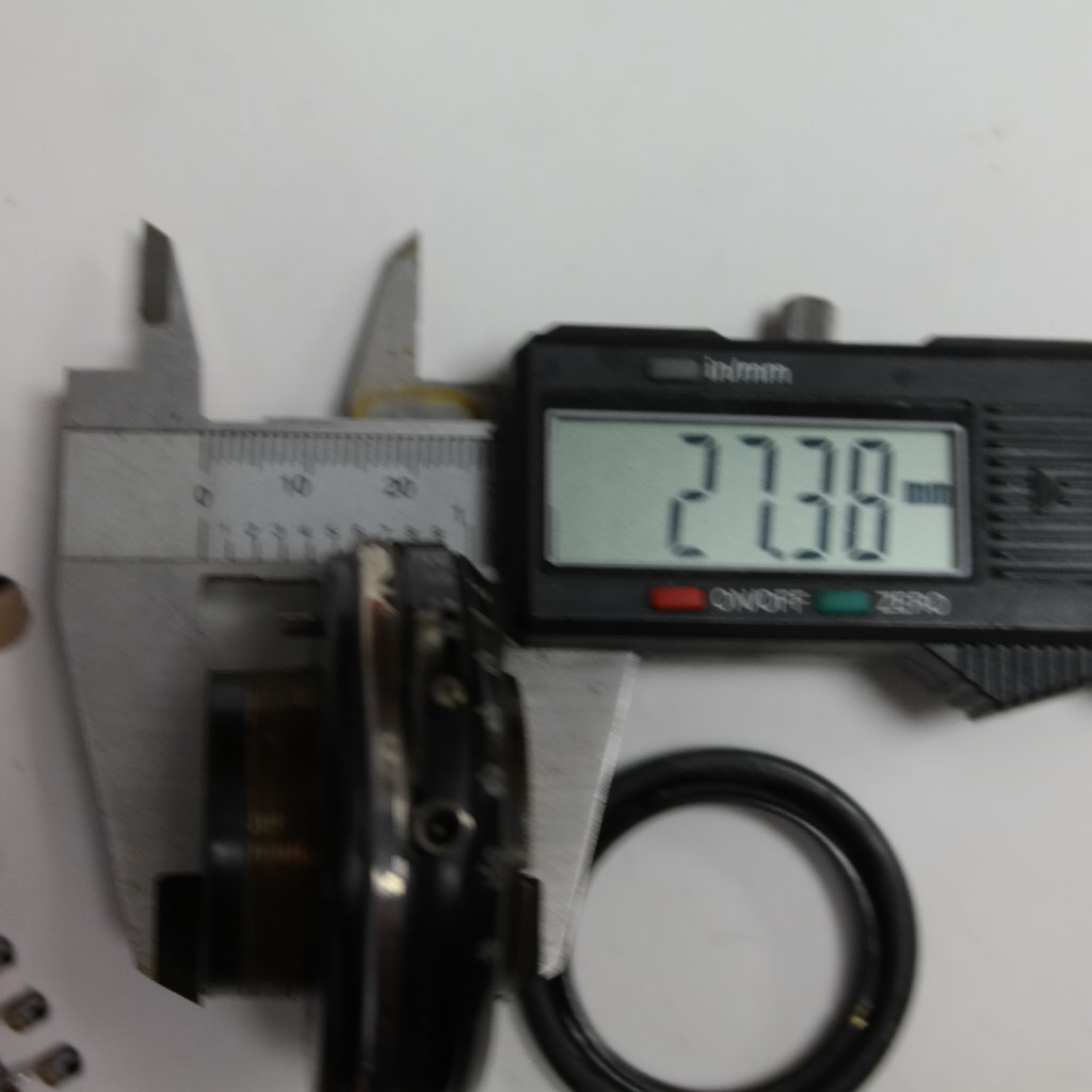

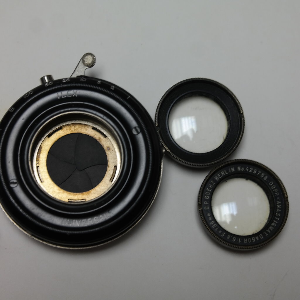

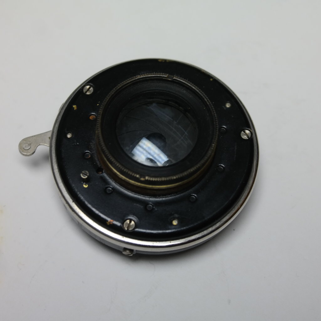

Well, I found a shutter that my cells screw directly into. Both front and rear cells have the same size threads, which certainly makes things easier. I measured the distance from the front of the front cell to the rear of the rear cell, and it's right around 27.38mm. Now all I have to do is find out if this is the normal distance between cells or not.

Seems to confirm your cells were ordered for an american shutter, I guess. And although I own a specimen of the Universal #0 (?) shutter I don't own Dagor cells for it. My present 135mm Dagor is a somewhat older item fitted in an old Compound shutter. Its front-to-end distance is abt. 25.4 mm, and the flange-to-flange distance of the shutter itself is 18.5 mm, which is standard for prewar dial-set #0 german shutters. However my guess would be, that your shutter fits the bill.

Thanks for this information. Yes, I'm happy the threads, front and rear, are the same. I mounted the lens with Universal shutter onto a lens board for my 4X5 Toyo. I plan on taking it out tomorrow and see how it acts on 4X5 sheet film. I'm also going to dig out some older Compur shutters and I'm pretty sure it will fit them also.

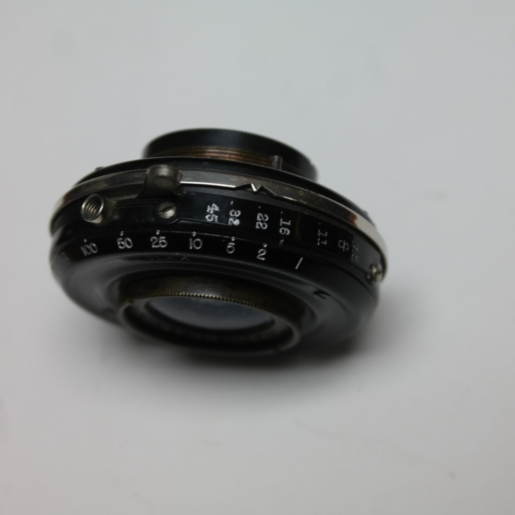

Just for fun, here is another ancient 135mm Dagor. It is in an original early Compound shutter. The diameter of the cell threads is 27.5mm and the tube length is only 23.5 mm front to back. I know it is original because it still carries the bizarre old Goerz aperture scale. Someone in the past thought enough of this lens to substitute it for the Zeiss glass on an ICA 205 Ideal short bellows plate camera. I rescued it for use in a light weight field outfit, mounted on a 4x5 Tachihara. This thing is tiny and turns around inside the folded camera.
The good thing about the old Goerz aperture scale is that at auctions some potential bidders might think that the lens has been put in a shutter made for another lens, maybe with the wrong spacing and that the aperture scale is off. So you can get it cheaper. If you are lucky, since a lot of sellers try to sell Dagors for high fantasy prices these days.
