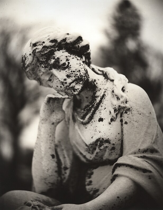

Do they look like this in the print?? I've not gotten these with HP5+ and pyrocat roll film but I do with FOMA 100 in Pyrocat. Take a look at the top. The mottling is there in the top left and right corners.

It's a bit hard to tell with the low res scan. For me they print as tiny, pin-prick sized black spots (35mm film enlarged about 6x). It's only on examination in the enlarger with a grain focuser that the peculiar shape is evident.
