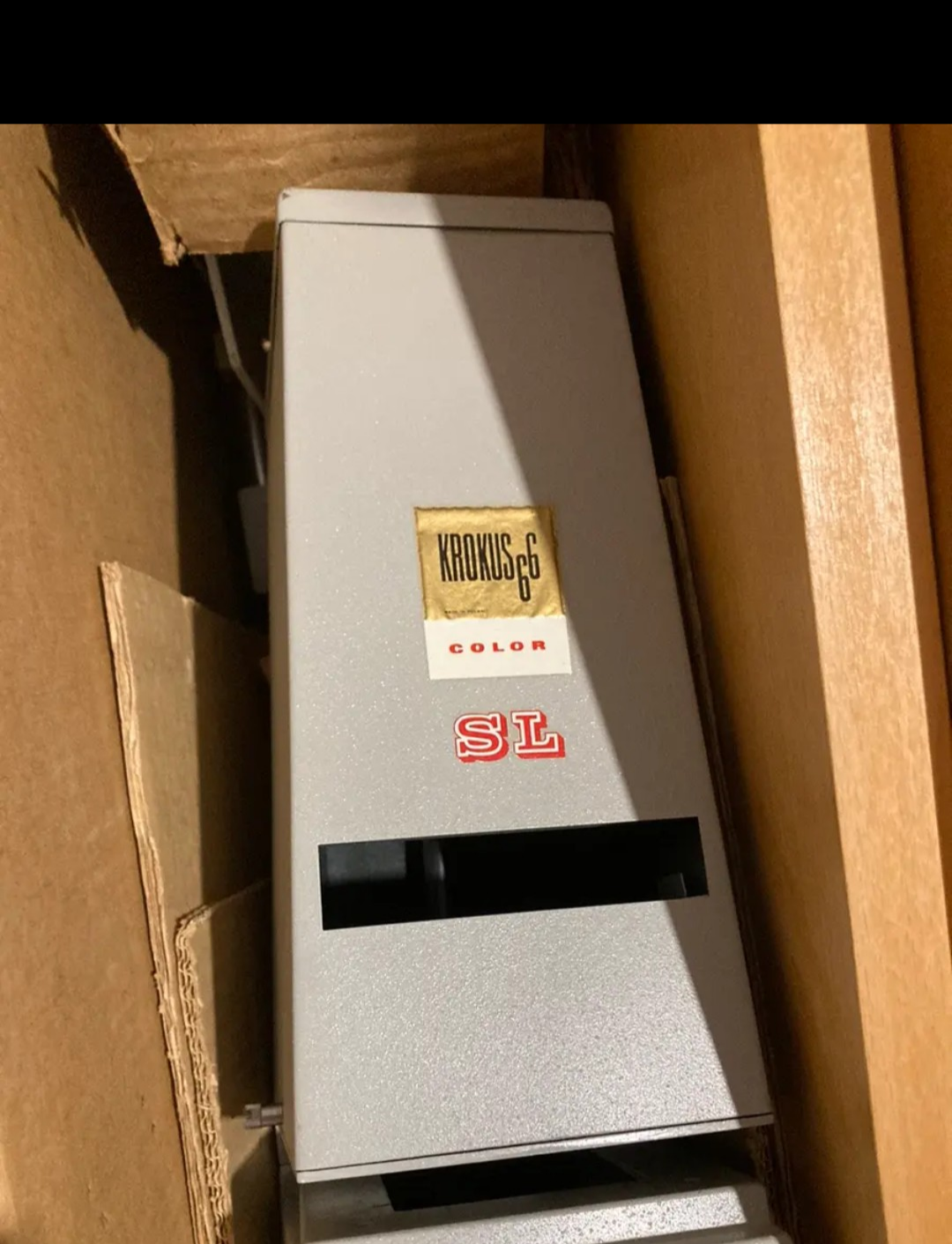

i would like to buy a Krokus 66 SL as in the picture and looks very good but my question is:
  • i don't see any mask for the 6x4.5 ... can i still use with that format ?
  • i don't see any mask for the 135 ... can i still use with that format ?
Same, i find a Meopta Optemus 6a but still don't looks are available masks for the two formats i need, can i still print these formats with excellent results ?

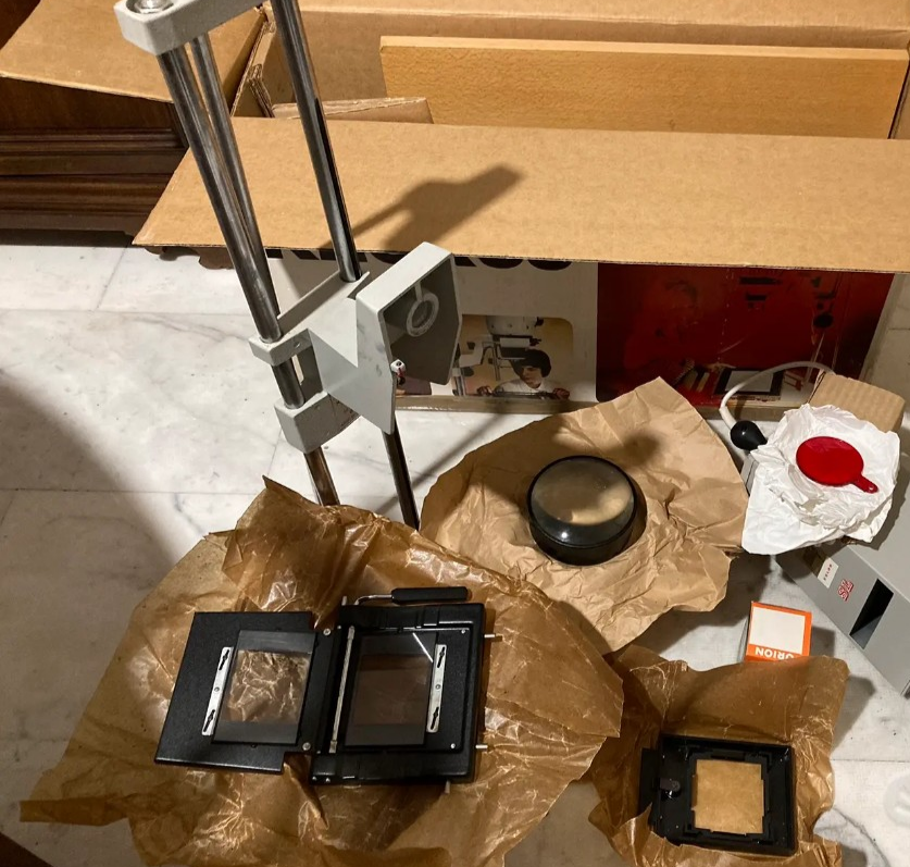

What kind of negative carrier do you have ? probably is different from mine or not ?

Mine has 4 sliding blades that crop from about 1/2 frame to 6X6. I think I mislead you as I have an Anxium not a Opmus so the standard negative carriers are different. Looking at the manual I don't see a cropping carrier, I did see an insert, as others have posted you should be able to make an insert along with inserts for 35mm without much trouble.

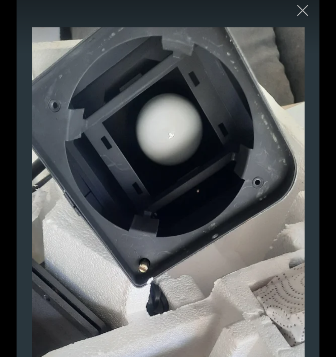

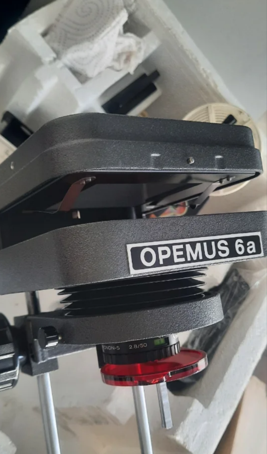

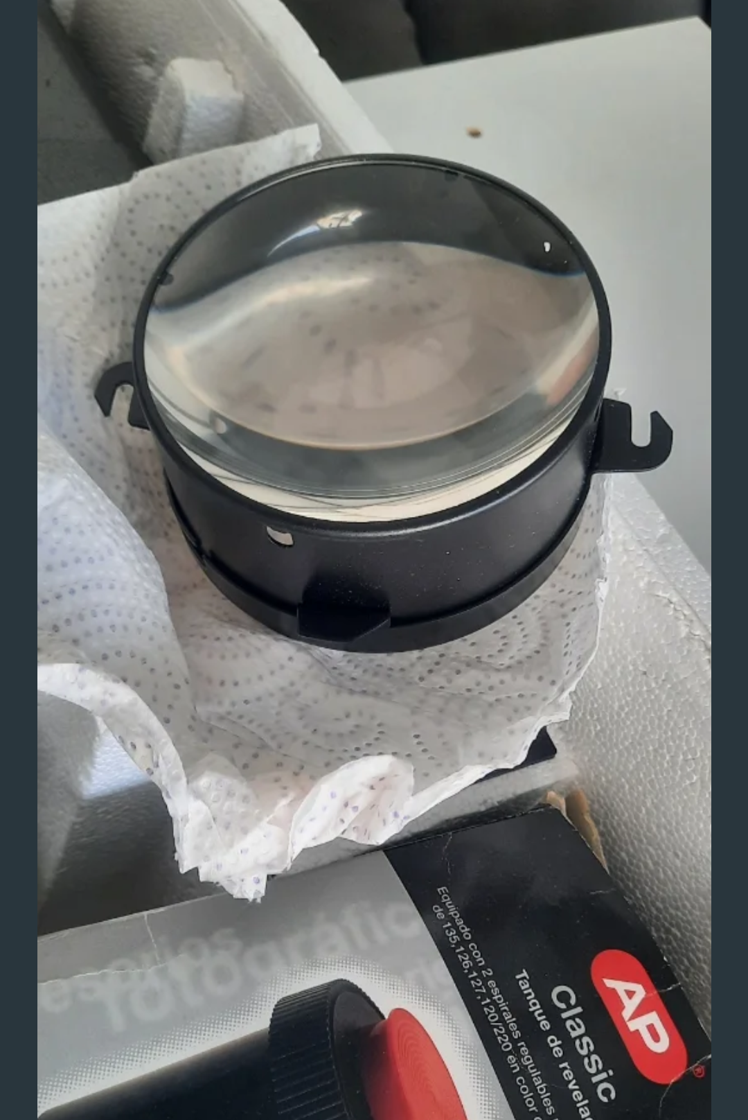

that part here is normal as it is ?
i see too many scratches and only a screw
There is a nice guy from france who 3D-prints masks for different enlargers including opemus. He made me custom masks to enlarge the negatives from my Bronica GS1 in my Focomat IIc with a slight border. As 6x7 negatives can differ quite a bit actually depending on your make and model of camera this was very helpful and his service was fast and efficient.
You should be able to find 3 replacement screws, as for the scratches, a coat of high temperature flat black spray paint and you will be good to go. The question is, is the price low enough to make up the trouble to bring the enlarger back to like new?

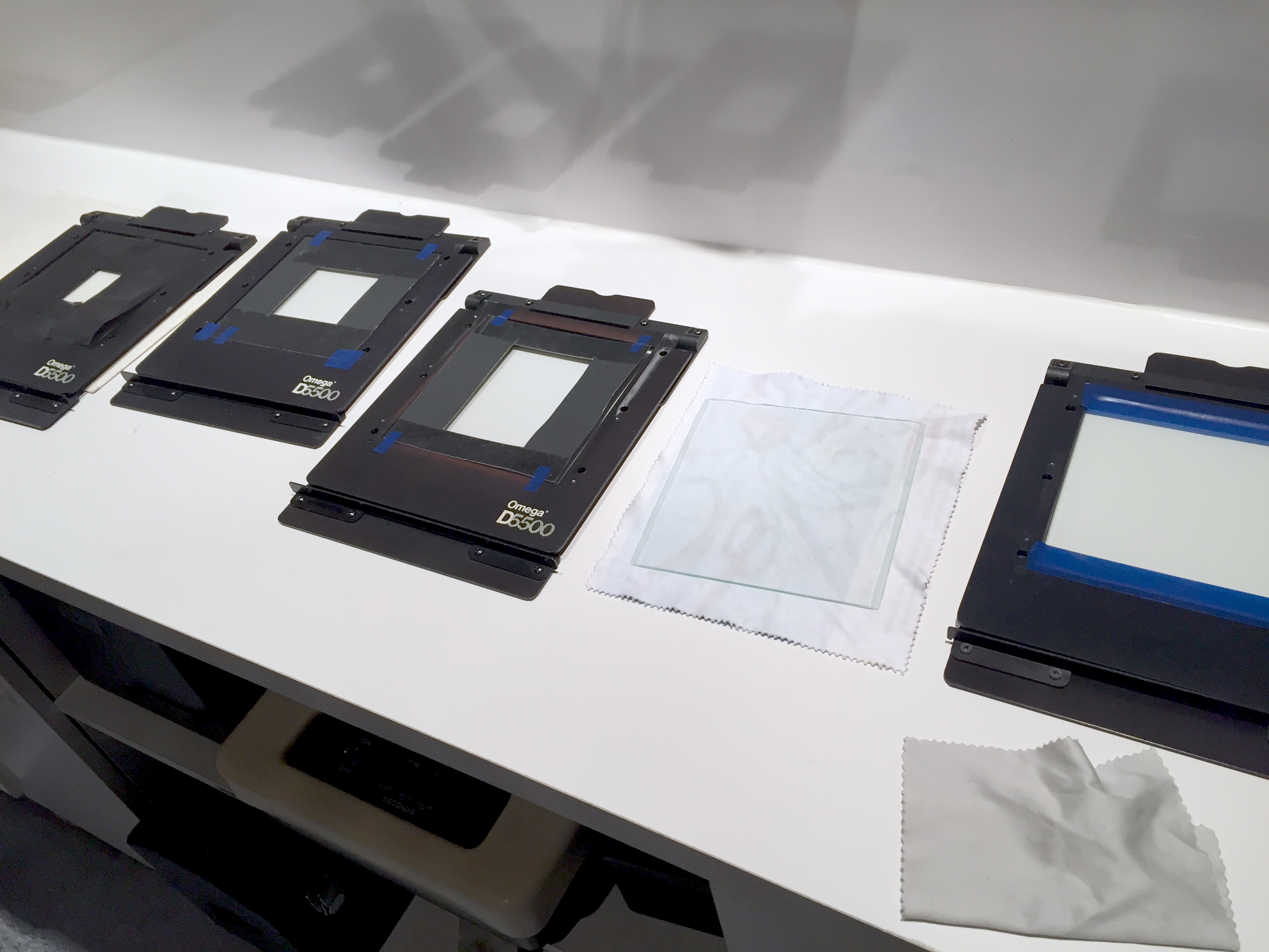

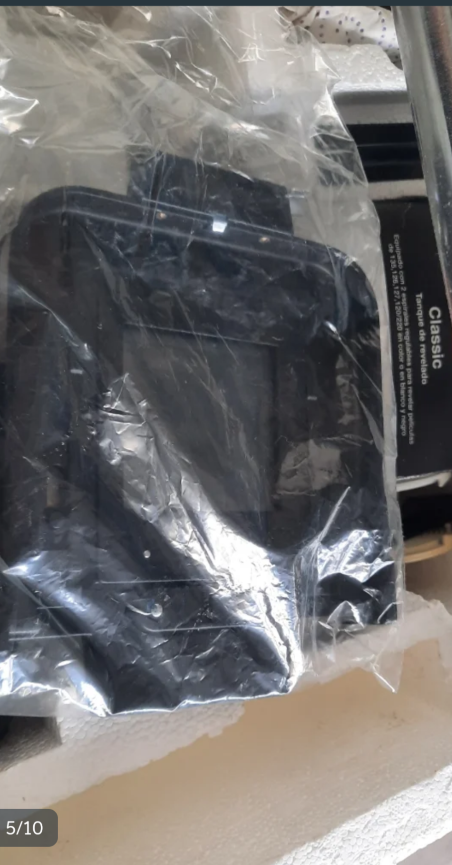

Looks like you have a glass negative carrier.
This image depicts 4x5 glass negative carriers I have masked with tape, black construction paper or the black plastic used to wrap photographic paper or sheet film.

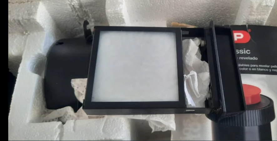

but as show here the Krokus has adjustable curtains in the negative holder.
is maybe the same with the meopta 6 ?
