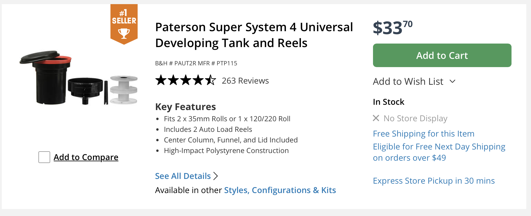

HI Dan,
I love my Stainless Steel Nikkor reels and tanks, but finding a 127 reel may be difficult. The standard plastic Paterson reel can do 35mm, 126, 127, and 120 right out of the box (and I have modified one of mine too. handle 110/16mm). You can get the whole kit: tank, two reels, swizzle stick, etc. for $33 from B&H.
