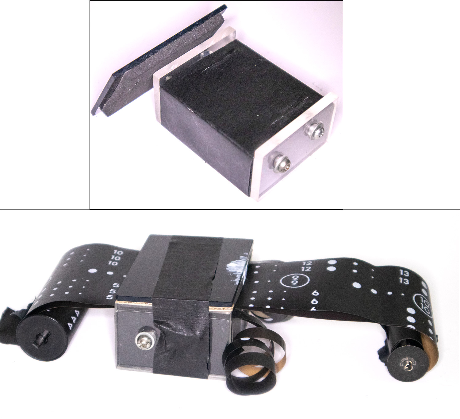

bripriuk
Aug 20, 2014
37
127 Format
I use one of these:
FILM SLITTER
I've modified it to cut the backing paper as well as the film by adding 2mm to each side and increasing the slot clearance. Don't try it with Ilford film, the backing paper is really tough and the numbers are too faint to see through a red window.
Brian
