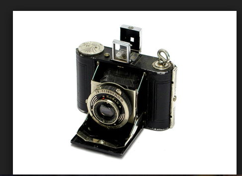

i'm glad. I have a Vollenda, from 1937 or thereabouts, schneider radionar lens, folds up neat, cutest thing you ever saw, gets 16 exposure on 127 and is really very sharp.
I've been delaying using it to shoot my last three rolls of film because I hate not having film available, now I do.
