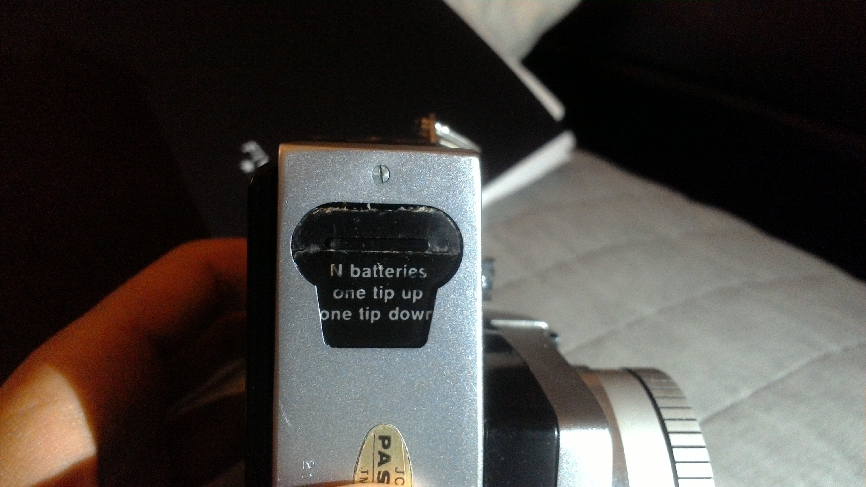

Also, I had found a plastic cover on the bottom of my camera reading... " N batteries; one tip up, one tip down". Is the light sensor on the front battery powered? It looks like a door that is stuck shut and I'm not really sure how to open it to find out. Seems weird to me.

Likely you have to push down the smaller tab, raise the broader tap and pull it with your fingernail.
BUT the batteries have leaked. That likely will hamper opening of that cap and removing the batteries. Then you will have to clean the compartment. There is a chance that the battery contacts are gone and even more damage was done to the camera.

After reading an online manual, "one tip up one tip down" refers to the way the + side of the batteries go in. The battery door is supposed to slide open; but the door is completely shut stuck and can't be opened by hand. Would taking the screws out of the bottom of the camera to get better access be a good next move?

There is no other choice...
However, if the leaking batteries have not damaged other innards of your camera, the camera should work fine on ambient light.
Those batteries are only to fire a flash-cube you can insert on top of the camera.
Getting out the batteries though may prevent further damage and mess.
