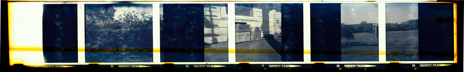

Attached are photos from the Kodak X-15 (w/ filed indexing pin) test.
I'm happy with the results (aside from the 1979 film which hadn't aged very well, plus a scanner line courtesy of an Epson V600).
Camera:
Kodak Instamatic X-15 (w/filed indexing pin)
Film:
1979 K-Mart Focal Color Print (80ASA,12exp.)
Processing:
Adonal 1:100/semi-stand/68 degrees/1 hour
water rinse 1 min
Kodafix 5 min
wash 10 min
Ilfotol rinse 1:100 1 min
Scanner:
Epson V600
The pre-exposed frames are present as would be expected and there is a double exposure in the final shot. I believe I accidently tripped the shutter while advancing the film to it's end.
Well, the filing of the pin on the X-15 seems to have had only good results. However, the question remains whether or not pin-filing will work on other instamatics or on other 126s. Hmm. I'll file the pin on a 126 Hawkeye that's floating around here somewhere but it may be a while before I try this on my Kodak Instamatic 500!
Standard 35mm Tri-X next time with 2 1/2 advance strokes between shots.
In all, I'm looking forward to shooting the square format (with and without sprocket holes).
