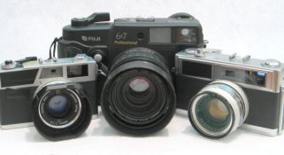

I have a Konica 35mm RF which is a pretty decent (and cheap) 35mm RF camera and I'm rather happy with it for the quick and dirty shots. However, if I go on a photoshoot that requires time and thought for composition, I would grab a MF SLR any day of the week over a 35mm.
When I need detail and high image quality, I use the larger format rangefinder with a cable release and a tripod.
When I need to shoot quietly and quickly, I hand hold one of my smaller format rangefinders.
