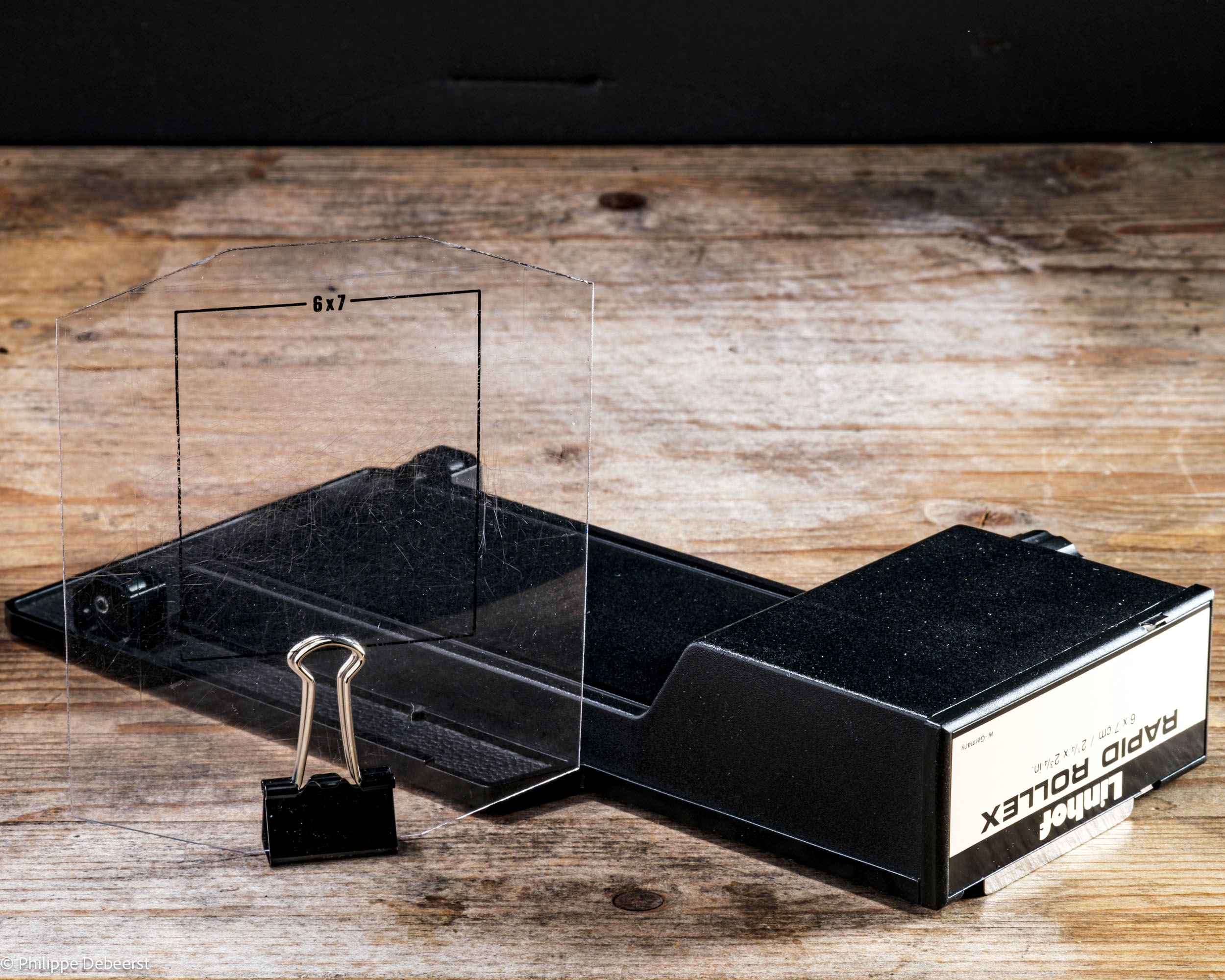

Philippe-Georges
Apr 11, 2005
2,680
Flanders Fields
Perhaps this?
