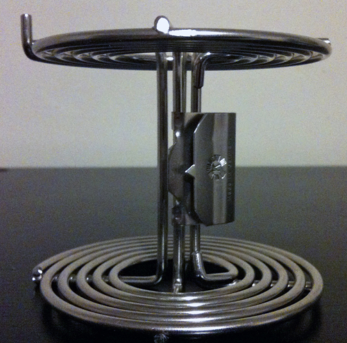

Hi, I hoping someone might recognize, or has experience with two of my reels.
I have included three photos of three different types of steel 120 reel that I have.
The one marked H/N 1 is my preferred reel, it a Honeywell Nikor with a hinged film clamp. Works great, easy to load and the film never disengages.

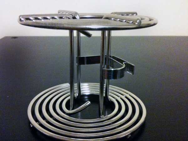

-H/N 2 is also a Honeywell Nikor with a different style of film attachment. I can't figure out how it works or how to secure the film. I tried loading it (blind faith) but it just doesn't hold the film - at least in anyway that is obvious to me.

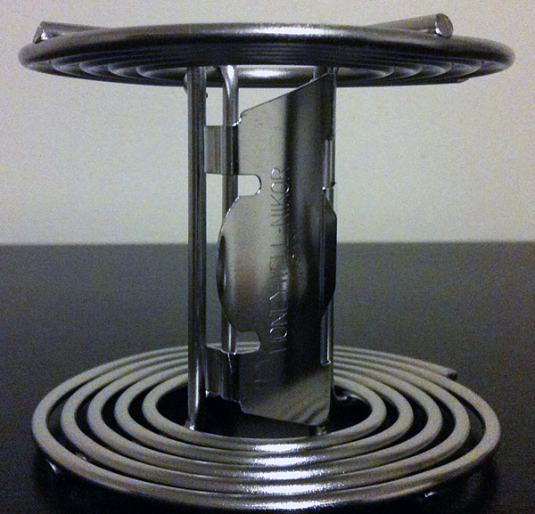

- The photo marked German is Made in Germany and has a spike of some sort. Here again I can't seem too get it to secure the film. I've tried piercing the film with the spike - easier said than done. I gave up one this reel.
Any thoughts or instructions?
Thanks in advance.
Jeff

Those are all great reels which I also have. The one with the spike I think is maybe a Kindermann from Germany. I insert the film in the space behind to the spade then bend the film and pull, so the spade pierces the film, then proceed to wind on the reels. The two Nikors clamp the film so you can then wind on the reels. Practice with your practice roll until you get the hang of it. Or, send the ones you don't like to me, I will be forever grateful.
:smile:
Thanks Fotch. My guess was not far off. I have been using the Nikor with the hinged clamp for many years, it's a great reel. I look for them at whatever camera show/flea market that comes up. I have only seen one once, so now I have a pair. The other Nikor with the thin strip of metal doesn't seem to clamp in any way. Maybe it's bent. The Kindermann might need more practice. Thanks again.

The "German" reel looks like a Kinderman; if you check the clamp carefully, you'll notice an embossed "K" in a circle with "Made in Germany" below it. My other Kinderman 120 reels (older ones, I think) work differently. They have a spring loaded puncturing pin which is raised as the film is inserted and then released to punch directly through the film. That design works like a charm, and I can't figure out why it was ever changed. With the one you have, it helps to use a paper punch to put a hole through the film (centered across the width, of course) instead of trying to press the spike through it. Doing that sometimes also punches a finger!
