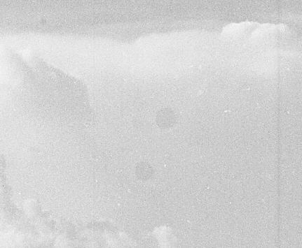

On some FP4+ (120) that I processed recently, I noticed some problems. On the negatives there are small, more or less round spots of lower density (but not clear). Most of them are around a millimeter or less in diameter and can occur almost anywhere in the frame, but of course are most noticeable in the sky areas. See the attached scan for an idea of what I'm talking about. I've also noticed that they seem to occur only in the last 1/3 of the roll.
I always rap the tank against the counter after each agitation and have never had any problems with 35mm. I'm using a Paterson tank and plastic reels. My developer is XTOL 1:2 (if that makes any difference) and I do not presoak my film.
From what I've read, it seems 120 has a more problems than 35mm with airbells and that a presoak can help. Any thoughts?

Looks like air bubbles and I still can be wrong. Expose a test roll of film; and pre-wet the film before developing for two minutes. You will need to extend you development time by 15-25 percent. Good luck.

It looks like air bubbles, and the procedure you described is also not inconsistent with this.
I used to see this type of air bubbles most frequently with Fujifilm Acros in 120 size, but I've been getting calls from users of HP5 Plus and FP4 Plus in 120 sizes who get this problem in last few months.

Looks like airbells, but they seemed to have been knocked off the film part-way into the developing cycle so some development did take place.

These defects are absolutely identical with some that I started to get recently with 120 neopan. I've been developing film for 40 years and had not got air bells for 39 years or so (mostly 35mm and some 4x5).
So I started to give a prerinse of several minutes (with agitation and vigorous rapping) and the problem went away completely. But I'm still puzzled by it. I had always rapped vigorously and agitated for 2 minutes at the start of developing. So now I always prerinse 120 (no need for 35mm) and don't have the problem.

The best is to agitate vigorously during presoak, but it is best to do two presoaks. The first presoak removes much of the anoionic surfactants used in film coating. They can form very stable foam that don't collapse by tapping the tank. I bang my tank very hard (my tanks are reinforced at the bottom!) but they don't collapse satisfactorily. Two presoaks with good agitation can wet the film evenly and remove much of the foamy surfactants, so that the developer solution can stay largely foam-free. It's a lot easier to agitate foam-free developer solution in tanks, and the risk of airbell defect is greatly reduced.

I test all these things (presoak, hard rapping 5 times after each agitation, agitate all 30sek/60sek ...), nothing help. It seems impossible to free all air bubbles locate between the film. The only solution I have found is prevent the production of these Bubbles by reduce agitation. With only one agitation every minute I get mostly bubble free results. But this is no real solution because I get another bad effects like high density edges. After many weeks of research i capitulate now and look about these Hewes stainless steel reels. I think the space between the turns are too tight and with 120 Film this is not necessary. Too bad there is no other plastic Reel type for Paterson available with wider turns.
