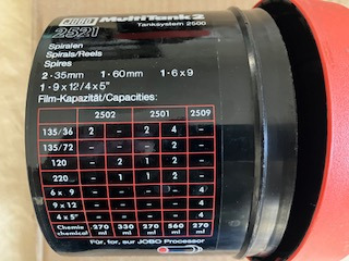

For the 2500 series tank, your single 120 film volume is wrong - it is 270ml, not 170. Probably just a typo, but confusing. The CPE2/CPE2+ have a motor limit to 600ml, but you are unlikely to get close to that.
The 2502 reel is rated for 2 x 120 in 330ml, and the 2501 reel for 1 x 120 in 270ml or 2x 120 in 560ml using the 2521 Multitank 2 (that's what in on the side of the tank).

OK, so pdf is not accurate. Just to confirm, the 2521 tank with 1 roll of 120 on 1 2502 reel, film loaded outmost end of reel (i.e., before red clip) is 270ml? This is very confusing indeed. My 1520 tank indicates 2 x 120 on one 1501 reel and the volume is 240ml, which is consistent with the pdf! What 1500 series tank do you have?

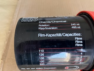

The 1520 tank with 2 x 120 on one reel is 240ml.
Actual smallest tanks in the 1500 and 2500 series:

OK, this is making sense now. The numbers you have are consistent with the pdf I attached. The difference lies in whether the 2502 reels are loaded with 1 roll or 2. With one roll only the volumes are less than they are noted on the tank itself. It seems that Jobo marked the tanks with volumes for 2 rolls per reel. Possibly to error on the side of caution. I verified that the pdf I originally attached comes directly from the Jobo website. I also found a Jobo publication that confirms the volumes and capacities for the tanks. I can't attach it here as it's too big. If you want a copy send me an email... luigi [at] luigipasto.com
