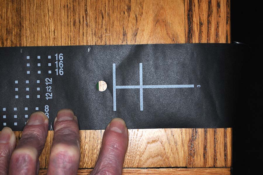

In 2005 I tried some Foma sheet film. I shot it at box speed like I would Kodak or Ilford films. Medium shadows were blank, box speed was way over rated, others on a different site had similar results.
In 2012 I purchased some Arista EDU Ultra in 120 to test some cameras with after repair. Box speed issue gone, preforms well. It is the same thickness as Kodak and Ilford films in the same format. The only thing I see about it is there is a hole in the backing paper at the end of the film that could fog the film if the back has a ruby window in it.
It is now my go to film for camera testing.
