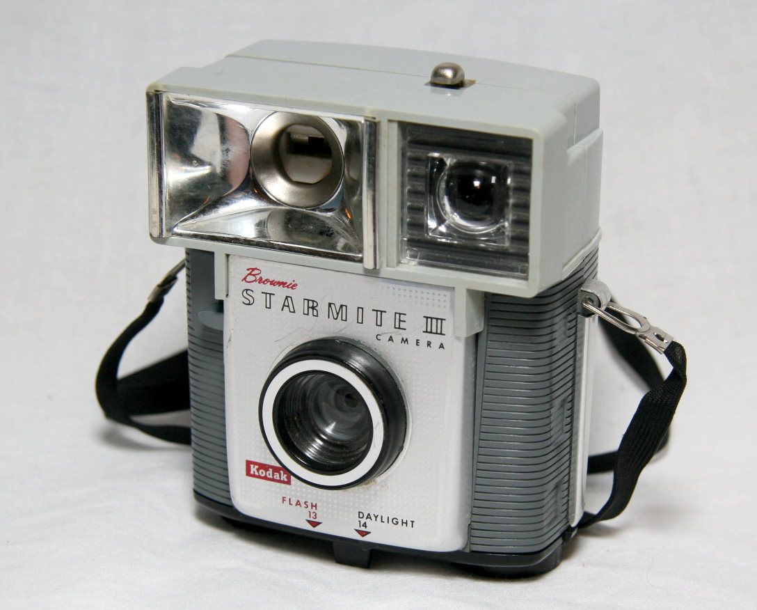

I never bought a Brownie because they're not bike or strap friendly.
My Brownie Starmite would have resented this remark!
