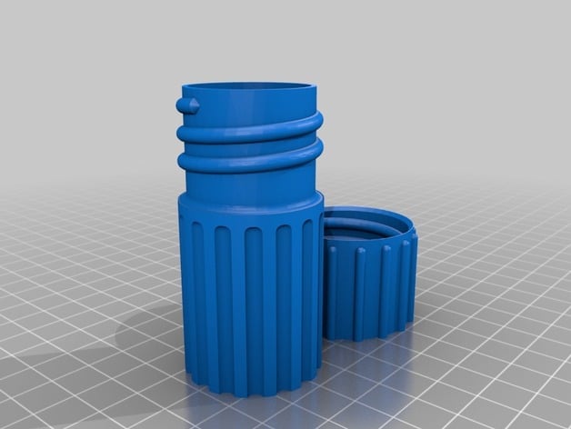

3D printing would be an option. Designs for one and two chamber canisters can be found here:
The material cost would be minimal, probably more depending on if you source them from a service like Shapeways or Craftcloud3D.

Having these 3D printed through a web-based 3D printer like the above mentioned or even Xometry might not be worth it. The best bulk price I'm seeing right now is between $5-$10 per holder (for both bottom & top pieces) when ordering 10+ canisters. (Adjusting material, infill and layer thickness to the lowest specs)
An option for sure, but if you know someone with a 3D printer, you can get these printed for much cheaper

I have thought about that, but unfortunately I don’t have a printer, and don’t know anyone who has a printer, so I can’t really make these economically.

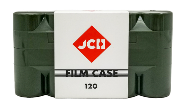

FreeStyle has plastic containers that hold 120 and 220 film.

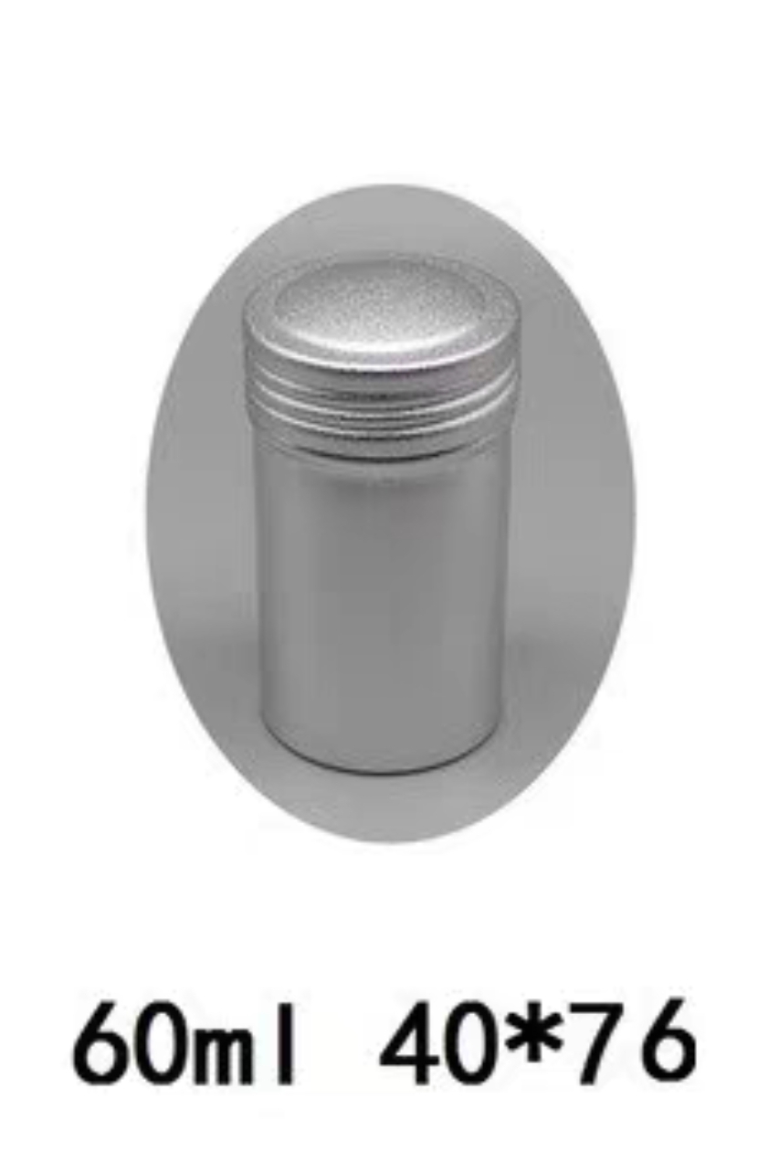

This aluminum can looks nice. It's about $0.5 in China. Maybe you can find on Aliexpress.

I have some very old pill canisters like that. They fit 620 but slightly too small for 120.
When you buy new film it comes in a foil wrap that can't be re-sealed. I often carry cut sheets of foil to wrap exposed film in.

Not looking for that, just looking for single roll containers, not big ones like this. these will not be for my personal use, they’re for film I sell.

I did actually find this, but I have no idea how the dreaded T word will affect the price, or even if they’ll change, so I’d rather not order from China at the moment if I don’t have to.

Try centrifuge tubes? They are way more cheaper.
