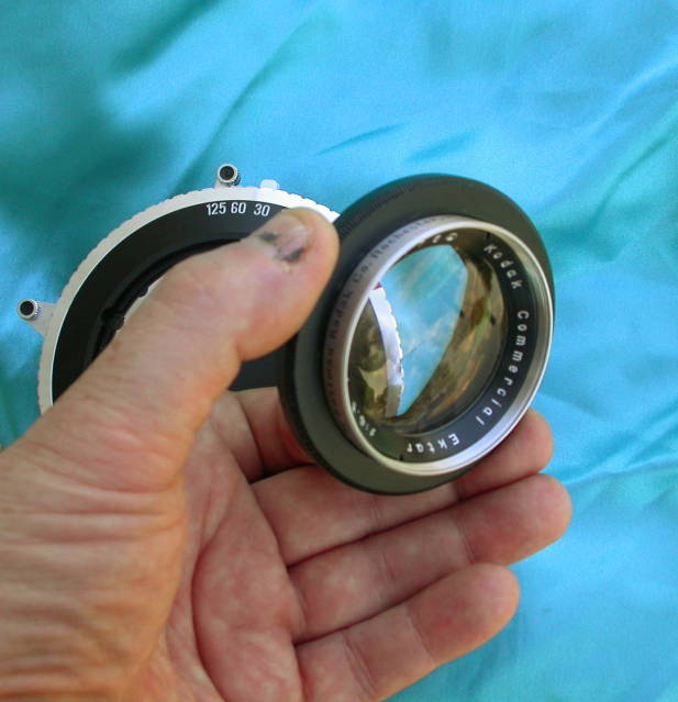

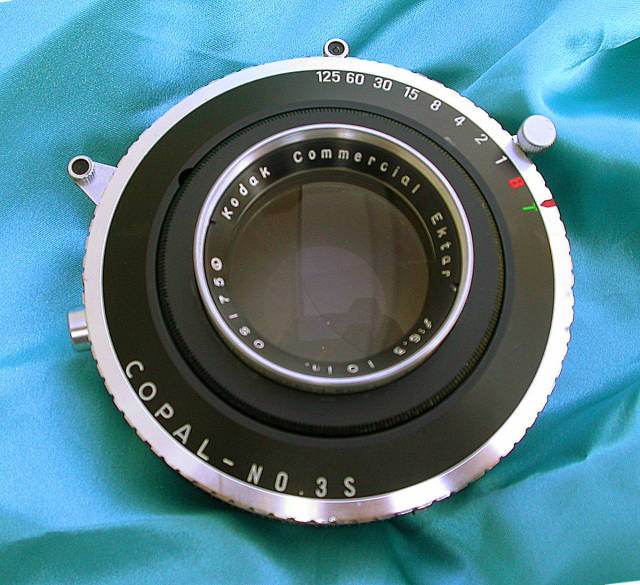

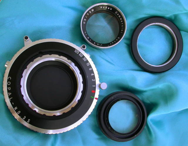

These pics might help clear things up a bit...
Front View...
All Apart (front adapter to the upper-right)
Front Cell Screwed Into Front Adapter
Rear Cell Is Direct Fit Into the Copal 3-S
(is not screwed all the way in)

I looks like the rear cell does have an adapter to reduce the diameter, but maybe the pictures are deceiving.
As mentioned above. Illex shutters made for Kodak lenses have different threads than the standard ones. You would need an Illex originally made for the lens. That's going to be tough to find unless you stumble onto a really trashed Ektar in shutter.

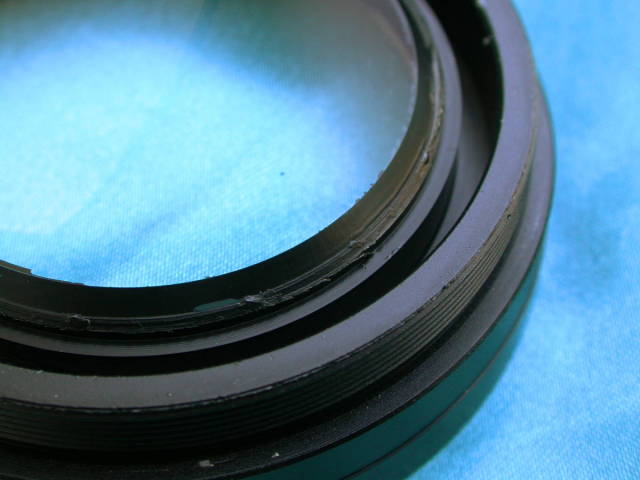

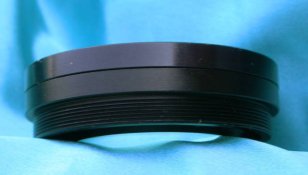

Maybe these will help...
Closer Pics of the Rear Cell Group

Your shutter is 1985 - ish. 2nd gen Copal 3 with chrome selector ring. In fact I never saw them call it a 3S until about that time frame. So someone has done a fine job of retro-fitting. 305 Computar f9 in that shutter trumps the he!! out of the ubiquitous Kodak.
