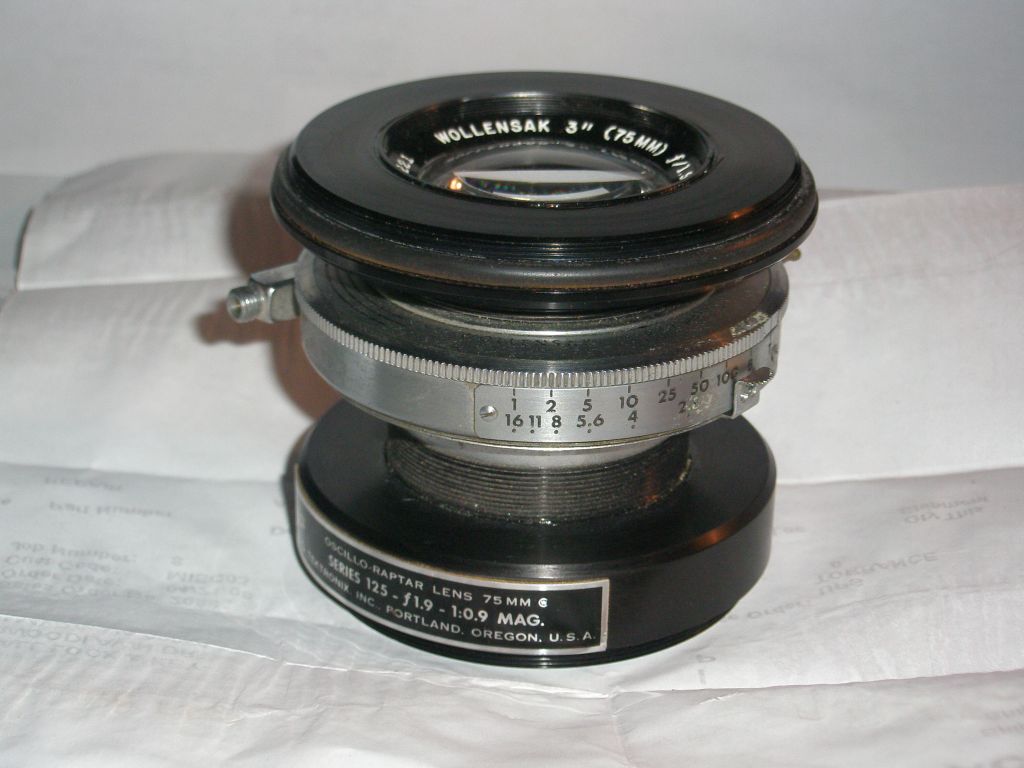

I meant normal as opposed to wide angle. It is a "Wollensak 3" (75mm) f 1.9 Oscillo-Raptar 1:09X coated lens in an Alphax Heavy Duty Synchro Matic Shutter", great guess!!!. I haven't played with an Alphax shutter yet, so it sounded fun.
Let's see, my 330's had 80's as normal, and they were 6x6 the RB had a 90 and that was 6x7 so I guess 75 is pretty short for the whole 6xX thing. Regardless, I don't think it will cover 4x5 at all.
Since you mention it, however, I have an oscilloscope camera on the way too, as well as an electrophoresis camera... Still don't have a fingerprint camera, I let a bunch of them go for like $9 or $10 a piece a while back.
Once I get my Kodak Reflex II back together and prove that a roll of 120 will go through it, I may try and snag a few of them... Unfortunately I let a whole pile of them get a way a few months back for next to nothing.
Seems until I get my darkroom built, I am playing camera repairman. However, since I have a Polaroid back to play with, I may have to actually take a picture or two pretty soon.

The Wollensak Oscillo-Raptar got here tonight. Now, this is a cool looking lens. A couple things I am noticing. There are 2 additional threaded rings I am assuming originally connected it to its oscilloscope. The front one has an o-ring on it. Because the shutter is silver, and the tubes/barrels/whatever they are called (the things the cells are screwed into) are black, it would appear that they should just screw out of the shutter. However, I am wondering if they are glued or somehow otherwise threadlocked? I can also see clear residue around each of the cells, that would suggest they are glued in place as well? Is this normal? I am considering reaching for the acetone...
Other than that, and the shutter seriously needing a cleaning, this is a very clean lens. But the coverage circle is way small (at least on my wall) :smile:
More as I figure it out!
