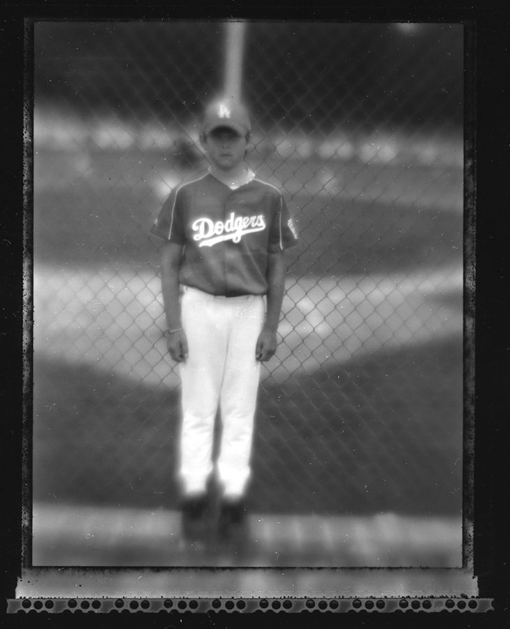

Alex's last Little League game...and first hit.

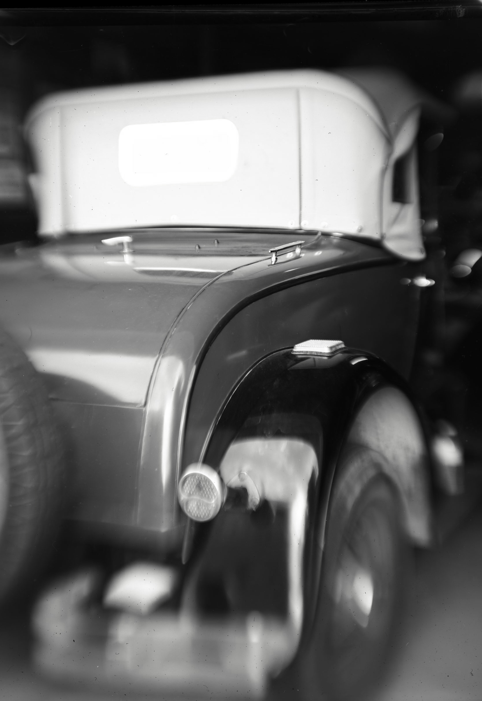

Oh, FYI, here's a test pic of my 42mm dia, 195mm FL positive meniscus lens. 5x7" area cropped from a 8x10 paper negative (scanned and inverted so i can share quickly). shot at about f16, despite the massively larger area than 120 film, it's dreamier looking than what my Holga produces, but it's actually better than i thought. I think maybe using the paper neg with it's non-panchromatic response might help in apparent sharpness. Things looked blurrier when looking at the ground glass. I fully recognize though that at 5x7, even f16 has a pretty shallow DoF at this focus distance.
I think if i want to stick to just a meniscus lens i might just need a bigger one. Looking at the Holga it has a ~20mm diameter lens, to cover a 56mm image. So for a 7" image seems like if this scales linearly then i would need a ~65mm dia or greater lens. Which is easy to find for 250mm (+4 diopter), less easy to find a 190-ish mm lens that's also cheap (aka not some fancy scientific lens). One thing that seems exaggerated on the larger negative versus the 120 film of the holga is the curved focal plane of the PMN lens. I don't know if that's just my particular example or just physics.
Just found a pair of 360mm x 51mm dia achromat lenses on surplus shed, so going to try the DIY rapid rectilinear and see how that comes out too once they arrive!

Just an update in case any one was interested. Still surfing the 'bay to find some other old lenses to play with, or otherwise destruct in a "constructive" way :tongue: In the mean time. Doing more tests with the lens elements i've got around.
First up. 195mm simple meniscus (bought from Edmund optics clearance section), when shot at f22-ish and the aperture in front of the lens, it produces some pretty great results. (accidentally grabbed my film holder by the dark slide and caused a nice light leak). When wide open, its actually hard to focus as the image is so soft. But stop down to f22 or smaller and i like it!
then i tried a DIY Rapid Rectilinear from two 360mm achromats from Surplus shed. This is actually surprisingly sharp wide open (f8-ish) in the center for $14 worth of glass gaffer taped to a copal press shutter. Certainly makes focusing easier than the simple meniscus, and it's pretty fun to see how much of a difference that extra symmetric element makes (although slightly apples to orange comparison since my meniscus is a simple single element, not an acrhomat doublet). The thing i don't like about this DIY RR lens is that the field of focus is super duper curved. Even when stopped down, it's much much more curved than the simple meniscus w/ aperture in front... so much so that i don't think it will get a ton of use. Although it does have an interesting look to it that i like. I think the main problem is that these 52mm dia doublets i have don't cover enough of 5x7 for what i like. they'd probably actually do pretty well on 4x5. but i've yet to find a cheap set of 360-400mm FL achromat doublets that are big... seems like it'd be cheaper to just buy a aplanat/rapid-rectilinear that was originally designed to cover 5x7 or greater if i wanted to explore more about how this lens design looks (although a properly designed/constructed Aplanat might look too good for what i'm after!).
