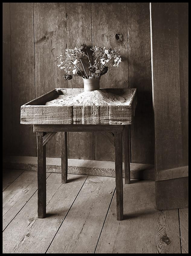

yesterday's flowers
dasBlute
yesterday's flowers
softlight and flowers in an old wooden church
Fort Ross State Historical Park
Canham 5x7, Caltar 75mm
Kodak TXP, pyrocat-hd
Love the light and composition; it really stands out, gives me a 3D feeling.
I keep coming back to this... It's amazing... I am also curious about what development method you used for TXP and Pyrocat? I cannot find any data on this combination apart from a semi stand time for 120 roll film on Digital truth. Just wondering if I should try some TXP and Pyrocat as I have both!
thanks naeroscatu and Andrew; I have yet to print this, it represents a substantial crop from the original 5x7, so not sure what I'm going to do yet... and getting the contrast in the upper tones will take some work in the darkroom to match the look I've tried for here. The neg has all the information, it's up to me...
I use rotary development for TXP in pyrocat-hd 1:1:100, [A:B:water]. Typical time for me is 13:30 @ 70 which is Sandy King's recommended adjustment for VC silver papers over the 10:00 @ 70 in the documentation. I rate TXP at 100, and usually place my darkest shadows on zone 3, as suggested by Barnbaum, giving me probably TXP @ 50 [!]. I get nice, dense negatives, and rarely underexpose :smile: I only consider N-1 development when I get something in zone 9 which is not too often. So, my regime will probably provide some good jokes around the photo water cooler, but it works for me.
As for TXP and pyrocat-hd, it's a great combination, there's a lot of dynamic range in that combo and the highlights don't seem to block up [my scan to the contrary] as I had often heard suggested of TXP. For TXP 5x7, it's all I've ever used; I'm on my 3rd box now.
Thanks again for the kind words of encouragement,
-Tim
