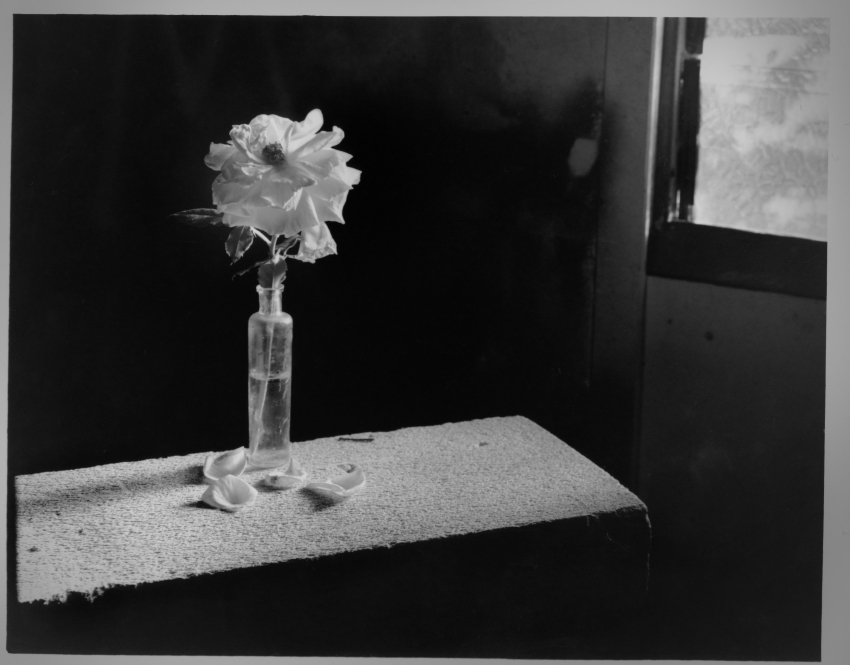

  • awty
8x10 scan, ilford rc pearl, two bath developer, Centrabrom S & Eukobrom.
f22, 12.7 sec base exposure, -1/2 on left side rose, +1/2 on right side. +2 on window, +1 on left brick. Thin Negative, but still heaps of detail.
Terrible scan but the print came out good.
Feeling like Im starting to get some
Garage on a brick
Technika III 4X5, 210 lens
f16
hp5, ro9 @ +25
Ilford rc 8x10, Centrabrom S & Eukobrom 2 bath. Liking the 2 bath developing.
I like the use of light and darkness in this scene.
Fantastic.......love everything about this picture
I want to take pictures like that :smile:
'Been busy, but wanted chime in on this. The light is compelling even in the thumbnail. 'Terrific use of the window light & the darkness beyond. As you mention, the detail comes through. 'Soft, but still clear. 'Really like the composition for lots of reasons.
