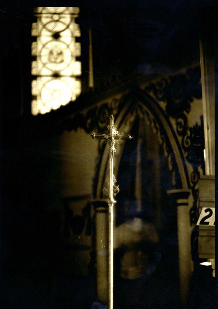

Have always like the look of Orotones and think I may have a way to get the look, using Ortho Lith film. Problem is, using Arista APHS film do not get what I would call a clean negative. Know the emulsion is soft (the film is thin) and even taking extreme care it seems to scratch easily. Anyone have experience using this film? comments welcome.

B&J 5x7, old brass RR lens
yup
Efke PL100, Pyrocat-HD
Arista APHS, developed in Ilford WT developer
Faux-rotones??? What fixer are you using? You may want get out one of the old acid hardening fixers that make toning silver prints such a bite in the butt.
I like the look. Are you mounting them on a substrate? Let us know how things progress.
yeah, Faux-orotone. The process Ed Curtis used to do. Best understanding I have is he used collodion process on glass plates, then coated the back side with gold pigment and banana oil.
Since this is a work in progress, it is the first semi-successful image managed to get. This all started after you showed me the image by Raymond Meeks last weekend. Made me wonder is using Ortho Lith film would work for this process as well. Had some Arista Ortho film, made a contact print - processed it in paper developer (Ilford Warmtone) mixed 1+9. water stop, and Ilford Rapid fix - 1+9.
Plan to try different substrates - glass and plexi, mount the film positive on one side, and try different gold coatings on the back (gold leaf, gold foil, and of course gold pigment with banana oil).

Clay, if Meeks did what I think he did...and it is what I did hear, the image is a positive on film. The same as you might do for unsharp maks or for making an enlarged negative (to be contacted again onto regular film). A film postive, then give it a background - in Meeks case the white enamel, in this one it was the back of box of Christmas cards...hey it's was the only thing I had to see if it worked. Plan to pick up some gold leaf and plexi-glass to start with.
Overall I think the process works, played with some frame glass earlier today and it does add some depth to the overall image. To be honest, was not sure if this would work at all. A bit surprised it worked this well. Now how to put it all together in a frame will be the next challenge...understand why Meeks did his the way he did now.
