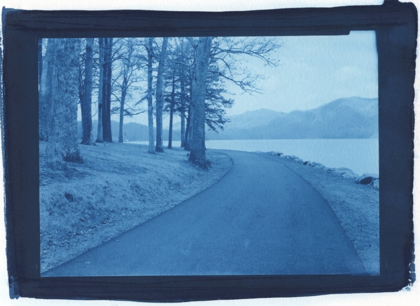

"new" cyanotype printed on Ryonet X-vactor exposure unit.
Johnson Co. TN USA
Deardorff 5x7 210mm lens
f32 1/2 sec
Delta 100 Xtol 1+0@80F
Arches plantine; 1% sulfamic acid for 1 min.; H20 for 5 min; wash for 20 minutes
Y6 yellow
Nice..do you delta 100 a lot? ? Just curious about it as I'm doing cyanotype and using fp4 or trix

I also use FP4+ quite a bit. The Delta 100 is giving nice results for alt-pro. I just ordered a box of D100 8x10 to enlarge 5x7 negs onto; have been using FP4+ for enlarged negs. The ES for both the "new" cyanotype and argyrotype has been about 2.1 on untreated Arches plantine. I did a paper test today with fumed silica on Arches plantine and"new" cyanotype ; a definite increase in contrast and loss of speed. The sensitizer behaves so differently after applying the fumed silica; still struggling for more even control...

Thank you for the reply...I was wanting to order more wp film this year and wondering if I should order d100...I previously ordered fp4 but am ambiguous about it..d100 seems to be more flexible with reciprocity...and if it works with cyanotype or azo I'll be happy. .again thank you
