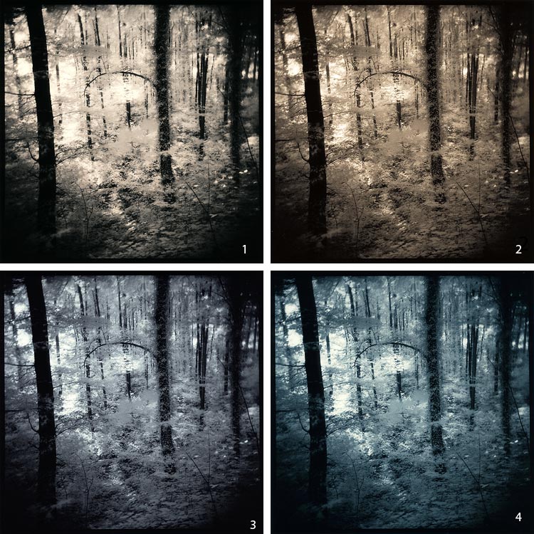

Walking up the Hill - Variations
#1 copper bleach redev. EasyLith 1+250 1:30min
#2 MT3 Vario & MT1 Selenium
bleach 1+50 1:30min - toner (thiourea) bright yellow 30sec - Selenium 1+10 1:30min
#3 MT3 Vario & Multitoner (chromogenic development)
bleach 1+70 20sec, toner (thiourea) bright yellow 30sec, bleach 1+70 1min - color developer (A/B/water 2+10+450ml - formers cyan and magenta each 2ml) 1min
#4 MT3 Vario & MT7 Iron Blue
bleach 1+70 20sec - toner (thiourea) bright yellow 30sec - Iron Blue Toner (parts 1-4+water 8+8+20+12+750) 30sec - clearing bath (NaCl) 2min
Holga
Efke IR820 & Finol
Fotokemika Varycon & SE6 Blue
RG715
